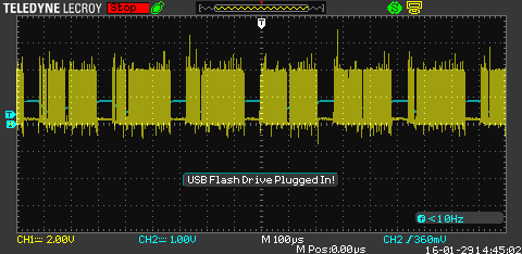

    Thanks for your reply. Ill get some detail over the weekend but in the mean time.
    For the source im switching between a bench PSU outputing 3.9VDC capable of 1A, or a 3.8VDC Lipo battery capable of 1.3A.
    The Yellow line shows the Power coming onto the enable pin
    The Blue line is Vout, which should be going to 3V3 but hovers around 0.8V
    Mostly if i remove Vin and re-apply it the blue trace will then go to 3V3, but not always.
    This is the trace on L1 when the error occurs.
    I have no load on the output
    I can see during the error state that there is a ~10mA draw from the PSU.

    I would also want to check if the device is going in some Undevoltage lockout, therefor I need you to measure the input voltage near the device.
    I would be great If I could get these plots with higher resolution and zoomed in to understand how the device behaves when it shuts down and try to restart again.
