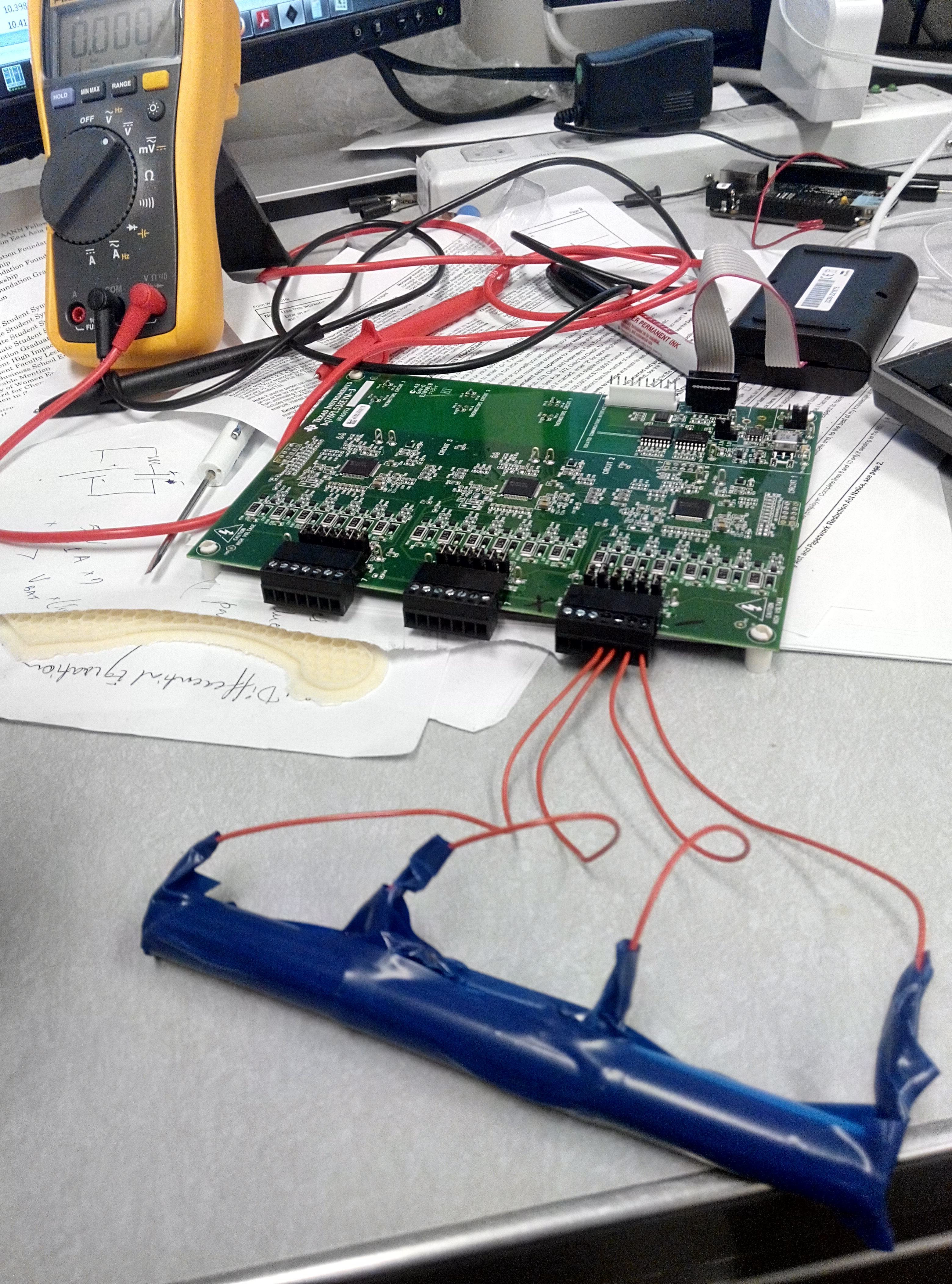

I recently got a BQ76PL536EVM. As the datasheet says, this has 3-6 series cell battery monitor. So we started by connecting 3 Li-ion cells in series. All the cells were roughly around the same voltage of 3.6V, totaling to 10.8V.
I have connected the battery pack as shown in the image, the negative of first to the right most pin and each further positive connection on the next pin. Then I connected the Aardvark adapter which was connected to a PC with the USB driver in place. When I fired up the GUI of the software, I see the following readings for cell voltages and brick voltages.

I also measured the voltages with a DMM after connection, and they are I were previously, all at around 3.6V. I am also reading the same voltages across the jumpers, i.e. across the jumper of cell1 (-) and jumper across cell1 (+) and so on. Also, the voltage across TP1 and TP2, which are test points at the ends of battery pack 1 was 9.17V. Also, there is nothing connected across any of the other circuits. and the other 3 cell slots of the first circuit are also left as it is.
Kindly help me diagnose the issue. There are multitude of inaccuracies here. The individual cell voltages are all inaccurate, actual total doesnt match shown total, and shown total doesn't match addition of shown individual cells. I have tried unchecking the "Dynamically Control the ADC"  option, but that didn't change the results much. I have restarted the GUI a few times as well.

  • Go take a look figure 4 in the datasheet.
    You have to connect Cell3->cell4->cell5->cell6.
    You also have to config your setting to 3S so you can avoid UV fault.
    Check register 0x30 and register 0x40.
  • Dear Roger,
    Thanks for the quick response. The facts were clearly laid out in the datasheet, I should have read it more carefully.
    Shorting the header slots for cell4-cell5-cell6, improved the readings, to very good accuracy. Changed the values on 0x30 to 3S combination which is just a plain write to 0x30. Writing to 0x40 required first writing 0x35 to 0x3A (page no. 42 of datasheet), and then writing the correct bits to 0x40, and then writing back to 0x3A a value of 0x27, did remove the UV fault. A refresh cleared the red marks on the GUI. However, this resulted in an alert, which keeps on blinking, which I am assuming is totally a false positive, and might need some reset, although the Figure-16 in datasheet titled "EPROM Programming" doesnt tell anything about he method to reset the alert bit.
