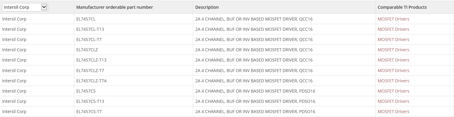

Hi all,  I am trying to find a similar device to the Intersil  EL7457 which is a pin driver / CCD driver translator unfortunately this device is quite troublesome and difficult to use and forget getting any support from Intersil

    I used TI's Competitive Cross Reference Search Tool using Intersil's Part Number, and it directed me to the MOSFET Drivers portfolio.

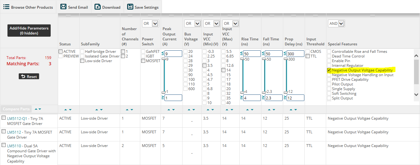

    I then searched their portfolio for outputs that support negative voltage and got the following products. It seems that the LM5112 might be compatible (Let VCC = +8.5V and VEE = -5.0V, edge rates are <15 ns using 2 nF load). Since I am not familiar with this product portfolio, I am going to move this thread to the appropriate e2e forum for accurate support. Thanks.
