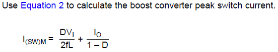

2. In datasheet of page-13 of equation-2 that I want to calculate switch current:
Where:

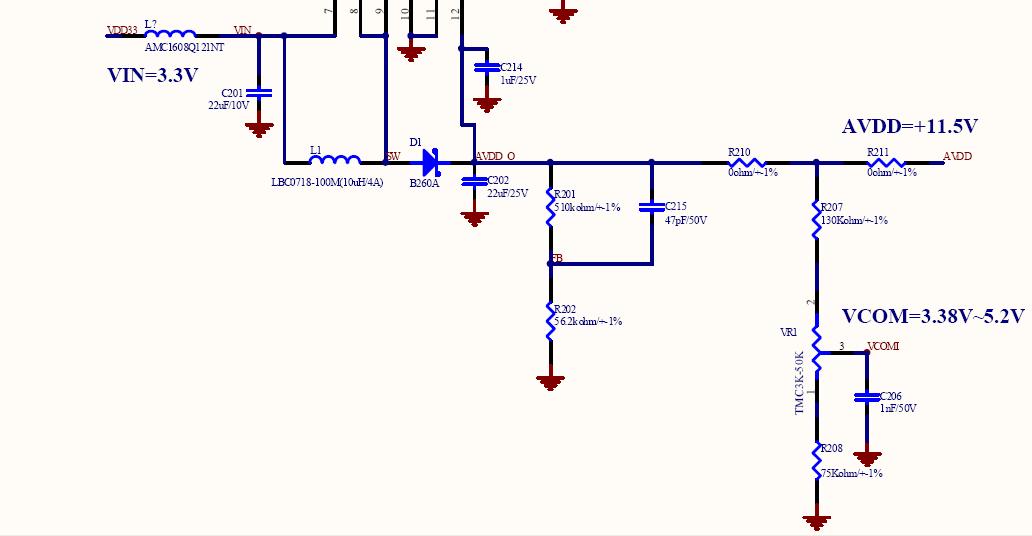

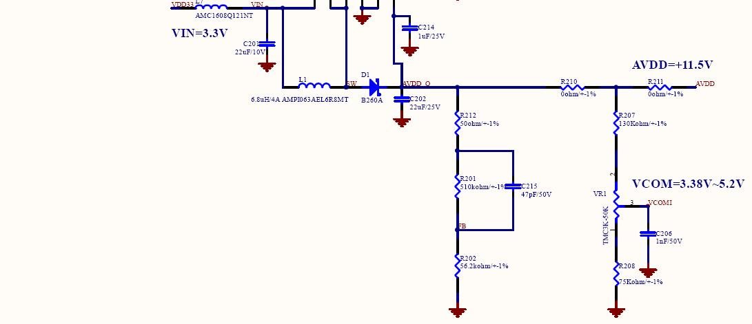

1. According to equation-1 and I got the duty cycle D=0.785(Vi=3.3V、Vo=11.5V、n=0.75)
2. L=3.9uH
3. Output current Io=0.9A
then I got the Isw is 4.463A, but it is exceeds the maximum current limit 3.4A which shown in datasheet page-5:

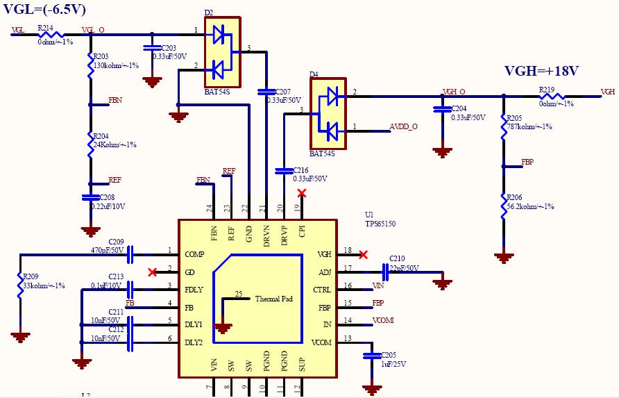

3. The switching diode which used in typical application circuit that you used schottky diode, is this for improve efficiency?

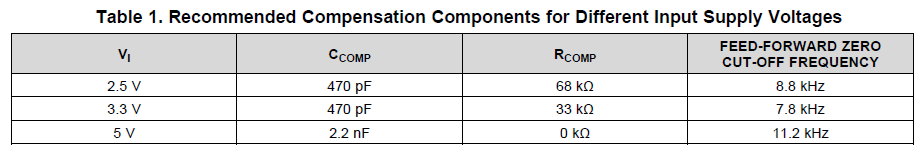

4. How can I calculate the Ccomp & Rcomp?Does it has a formula can be calculate?
