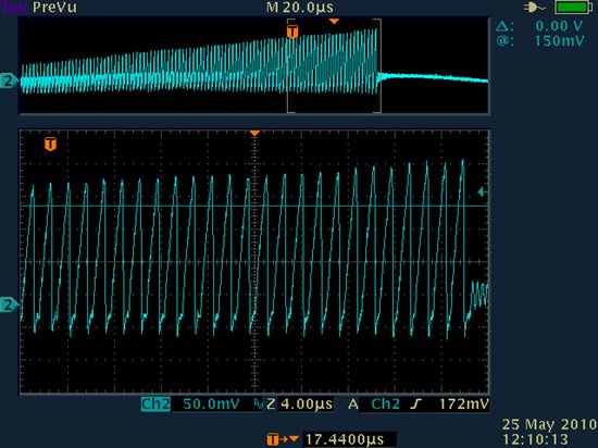

My current design is feading a load that takes periodic transient currents. During these transients I see the voltage on the ISNS pin start to rise, but the supply doesn't shut down until the pulses are around 230mV.
My question is this,  why are the pulses reaching 230mV? Is the chip out of tolerance, or is it because the current is getting that high during a time out period.  If there is a time out period, what is it based on, and can I change it?

    I'm seeing roughly 50 pulses after the ISINS pin reaches 150mV.  The last pulse before turn off is 230mV.  The last 30 pulses or so are above 180mV.
    I have a differential probe right on the pins, and I'm seeing pretty clean pulses with very little noise.  It really seems like there's a time out period, or the over current is tripping at around 230mV.

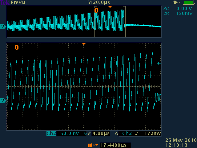

  • Here's the waveform at the ISNS pin.  I zoomed in on the last few pulses.  I doubt any ill effect is due to noise.
    The horizontal cursor  in the zoomed in picture is at 150mV. As you can see there's quite a bit of pulses that occur after 150mV has been exceeded.

  • Patrick,
    Thank you very much for the waveforms.  This looks to me like almost exactly what I described.  The early pulses are not exceeding 150mV for a long enough time to respond to the peak voltage, resulting in a failure to trigger the OCP fault prior to the PWM termination.  There are a few things you might be able to do to help this:
