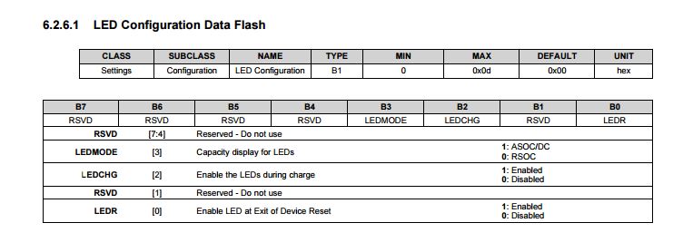

We want to use BQ40Z60 in our device to charge and fuel gauging 4S2P LiIon battery.
We need to have "Charge LED" on our device, not percentage of charge, but only charge process.
This LED will lights during charge process, and will off when charge will reach 100%.
Is it possible to configure pin TS2 (or TS3, TS4) of BQ40Z60 to indicate charge process so?
Pin TS1 we plan to use for measure battery pack temperature.
