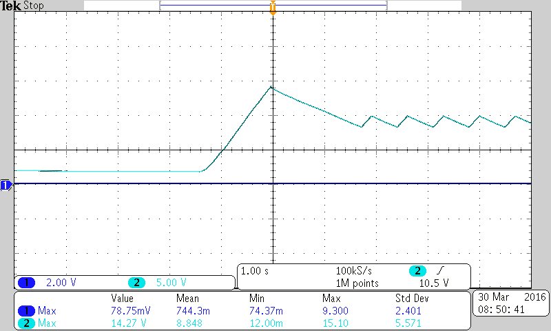

I made a schematic from PMP9643 and the Excel design calculator, which is below. The circuit board was layed out and prototype made. The prototype has been checked for connection errors. When connected to 100Vdc the VDD charges to 15v, then discharges to 11v, then plummets to 4v and starts all over again. see attached image for oscilloscope picture. The gate driver doesn't fire and seems to be disabled. Also the SD pin holds low despite the 19.1K oh resistance to ground at room temperature.

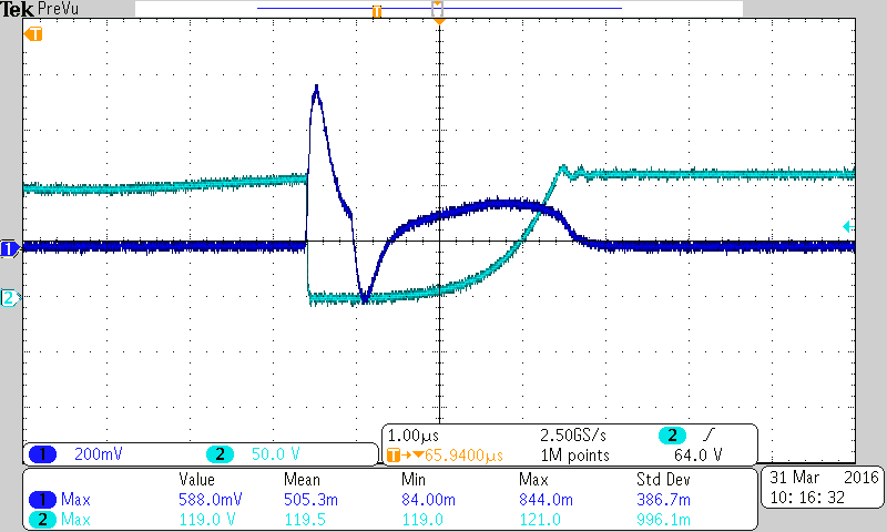

    CH1 CS, CH2 DRV
    CH1 Vsense, CH2 DRV
    VDD during startup

  • Hi David, per section 9.3.15 of the datasheet, the IC regulates the Vdd voltage between Vdd(latch_hi) and Vdd(latch_lo) in latched fault mode. The Vdd waveform indicates that the IC has entered latched fault mode.
    From table 4 the most likely causes are Vsense pin short, CS pin short, or DRV pin short. I see that you've halved the suggested CS resistance. This may result in the IC detecting a short on the pin.
    I would start by removing one of the CS resistors and see if this helps.
    Billy
  • I had come to the same conclusion also. So my post on March 30 with all the scope screen shots is only using one 0.240 ohm CS resistor.

  • The voltage on the CS pin during the switch on time should be a ramp driven by the increasing inductor current, but it looks like it's just a divided down version of the DRV voltage. This is the area I would look at.

  • I was getting a false reading with the scope attached to the gate and the current sense resistor. embedded is the picture of the CS pin along with the VDS during exploratory. The chip is now doing constant exploratory pulses. The CS waveform is still distorted. So I pulled out the transformer and found the primary inductance to be 300% more then expected.  A new transformer is being made.
  • Ok cool. The FET also appears not to be staying on, so there does appear to be a board issue here. Hopefully when you put the new transformer in it will help.
    Billy
