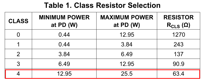

Can POE supply a ClassD amplifier with output power alter from 0 to 20W well?
Other Parts Discussed in Thread: TPS23752
Table 1 shows the load power classification characters of TPS23752, my question is if the TPS23752 supply a classD amplifier with output power changes from 0 to 25W and the RCLS is used with 643.4, will TPS23752 work well? What does the colum "MINIMUM POWER at PD" means? Does it means that the output power should not low than this value such as 12.95?  Thanks!
