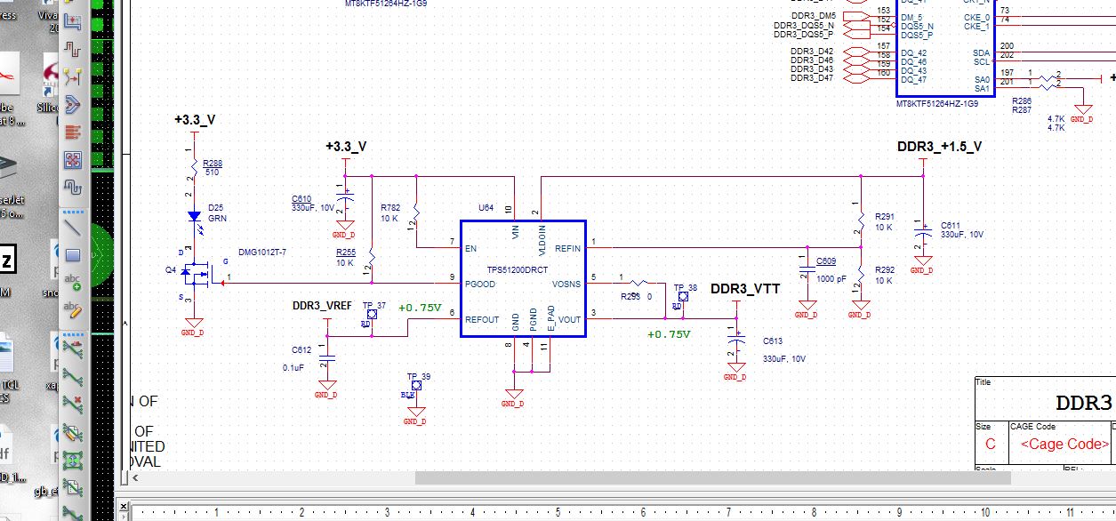

My customer is using P/N: TPS51200 switcher to generate Vref and VTT for their DDR3 module.  By using the Micron 4Gb module MT8KTF51264HZ-1G9,
the VTT output (DDR3_VTT pin at TP38 on the schematic) is oscillating at 4.5 Mhz unloaded and it is at about 5Mhz when they load the DDR3 module.
The oscillation problem goes away when they swap the DDR3 with a 1Gb module, P/N: MT8JTF12864HZ-1G6G1.
Can you please advise.
