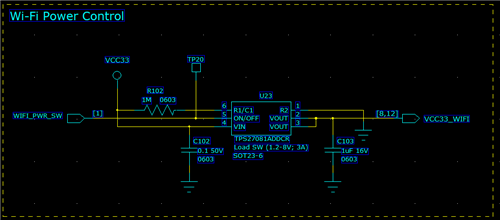

I have this switch between my TPS55340 3.3V SEPIC converter and my CC3200MOD Wi-Fi module. I am trying to use it as a load switch so I can completely cut power off to the Wi-Fi module when it is not being used (95% of the time).
My issue comes when I try to run this board from alkaline batteries (4 in series to yield 6V). Due to the way alkaline batteries act the voltage drops when the current increases. When I enable the Wi-Fi switch it causes the battery voltage to droop below my 3V minimum input voltage threshold. This causes my device to reset.

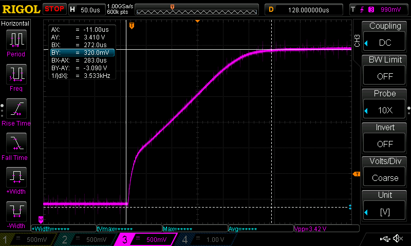

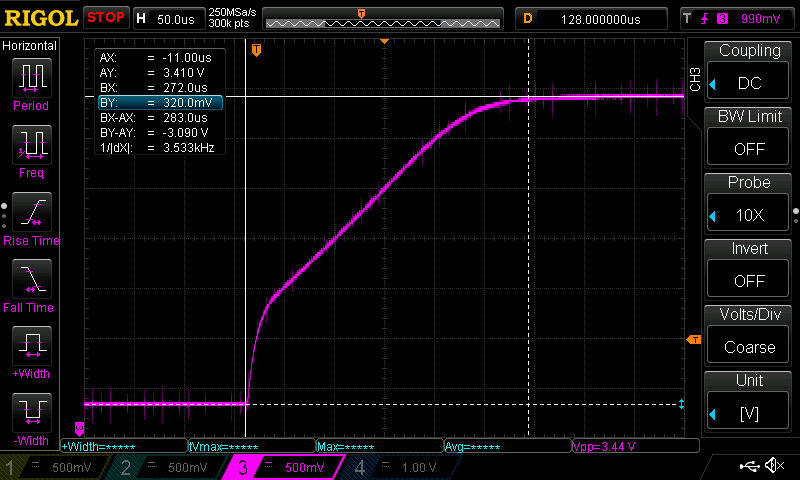

My assumption is the issue is due to the Wi-Fi's two 100uF capacitors trying to charge when the switch is enabled. My initial design had R2 grounded, but after discovering this issue I went back and added in a resistor between pin 1 (R2) and ground. It did not seem to help, so I began using the scope to inspect the rise time. Regardless of the resistor value I install (1K, 10K, 100K) it doesn't seem to make any difference in the rise time of my signal.
My initial design has a 1MΩ for R1, but I have also tried the recommended 10KΩ resistor with the same results.
Below is the result with R2 pin grounded.

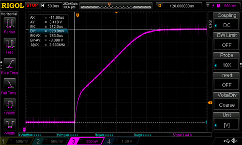

Below is the result with a 1K resistor.
The 10K and 100K are all essentially the same and it doesn't seem to matter if R1 is 10K or 1M.

  • Hello Kevin,
    From your schematic it looks like you don't have a capacitor between the R1/C1 pin and VOUT.
    This capacitor, in conjunction with R2, is part of configuring the turnon slew rate.
    Please refer to page 11 of the datasheet for more information.
    Michael

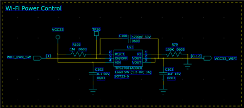

  • Thank you. Sometimes it just takes that second set of eyes. I assumed the capacitor went to ground and that my C103 was what I needed. I now realize that the diagram is showing that capacitor running through the part body and out to the R1/C1 pin. I still think there is a better way to represent this in the image that may be more clear but I do understand now. I added in that capacitor and it worked as expected.
    I went with a 100K resistor and a 4700pF capacitor as when I used a larger capacitor there were voltage spikes on the output of the switch when power was applied to the input. Is this expected?
    Also, there is now a 180mV level on the output of the switch. Is there a way to get rid of this while maintaining the slew rate?
  • Kevin,
    I absolutely agree, I think it could be more clear in the diagram and will take this feedback for when we work to update the datasheet next time.
    When the supply turns on, typically if it has a high slew rate, it can actually turn the switch on momentarily. If this is an issue, I would recommend looking at the TPS27082L, which has an additional logic circuitry that prevents the switch from turning on.
    What are your R1 and R2 values? R1 should be > 10*R2 Is the capacitor fully discharging. I may actually have to look further into the offset on the output.

    I would recommend decreasing the size of your resistors, one to two decades, to help reduce the offset.
    For example, I would recommend decreasing the 1M to 100k, the 100k to 10k, and consequently increase C1 to 47nF to have slew rate be the same.

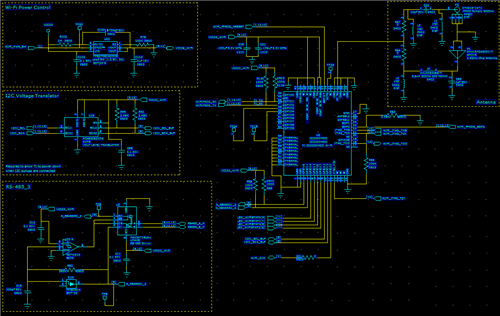

    Here is my schematic for that section of my design if it helps.
