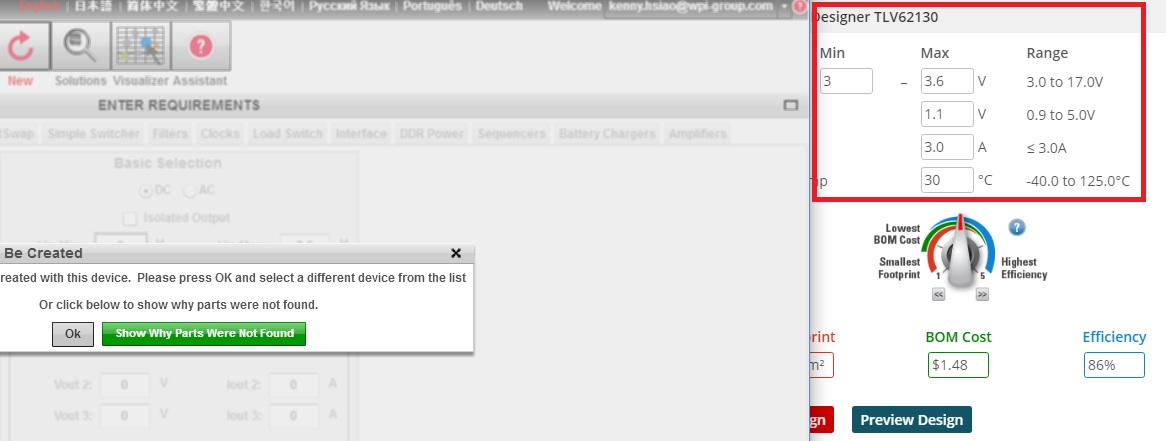

Dear Sir
Due to TLV62130A doesn't have webench tool
I use TLV62130 to do simulation ,but webench can't generator Vin=3.3V to Vout = 1.1V /3A or 1.5V/3A
Does TLV62130A support 3.3Vin ??
Dear Glaser
Thanks for your reply
Yes!! I know TLV62085 total BOM size and price may be better than TLV62130A
But ,we would like to use one solution to do for 12Vin/5Vin/3.3Vin
Below is the simulation result ,could you kindly help to check this issue
due to I would like to know what's condition I can use 2.5MHz with 1uH ,I think some condition have thermal issue
