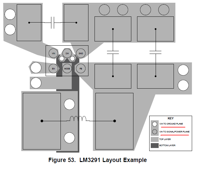

I found this image about the layout of the LM3691.
Are the "KEY" description colored in the opposite way?
