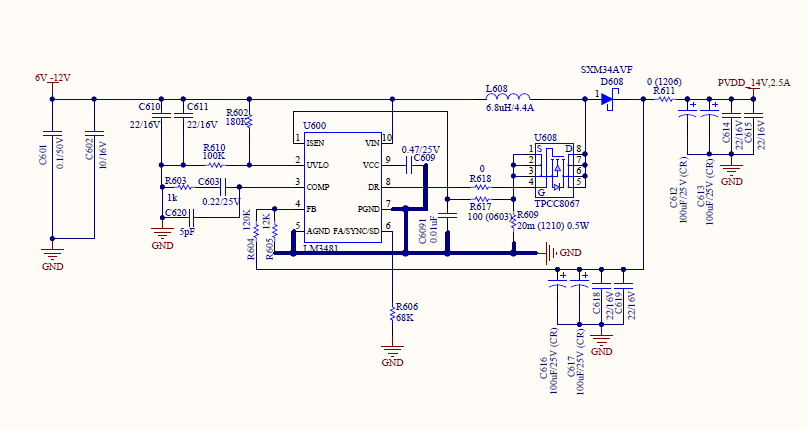

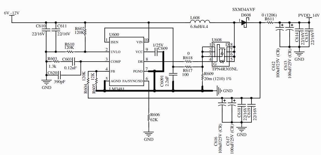

Hi Support,
Please advise regarding booster circuit below:
Design spec:
Input voltage: 6 to 12V
Vout:14V
Iout:2.5A
Freq~300k
Problem condition1:
When Input Voltage:12V, no load , voltage output can get 14V.
But during load about 200mA, voltage output will drop to 12V.
Problem condition2:
When Input Voltage:7.4V, no load , voltage output can get 14V
With load about 200mA, voltage output can get 14V.
Increase load more than 250mA, output voltage start to drop to 12V.
Please advise as soon as possible.
