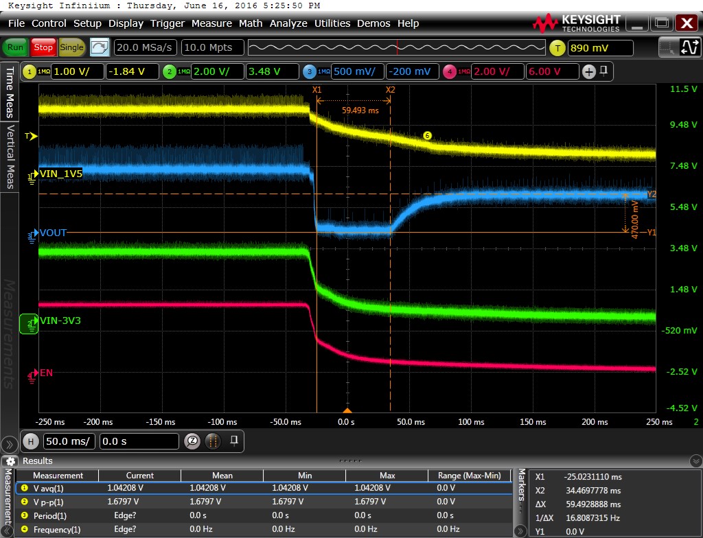

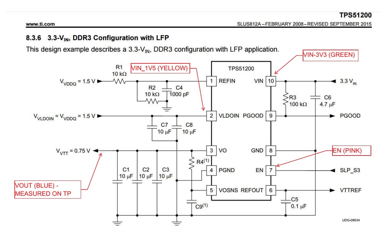

I am using a DC-DC converter, namely the TPS51200 for DDR power application.
Chosen design configuration is as seen on page 23 of the datasheet (DDR3 Configuration with LFP).
Now, I see a strange response when turning off my board, it seems that the TPS51200 generates an output voltage, even though EN pin signal is low.
Attached here is a scope dump, triggered on powering down.
Can anyone explain possible scenarios on how it can occur?
