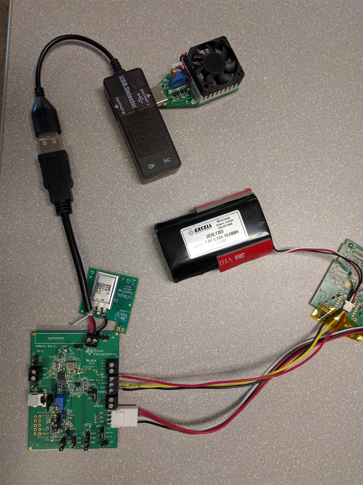

  • We have also tested using the TI bq27531EVM with the bq24192 charger. As you can see from this setup we have a large capacitor attached to the Sys pins along with a USB detector and a dummy current sink. Similar to our end product. (Capacitor is not shown in the schematic above). The system will enter Shipmode, but when connecting the adapter to exit from ship mode we can see that the charger and fuel gauge turn back on but the BATFET doesn't reconnect (i.e. the battery doesn't charge and removing the USB adapter power causes the system to shut down). Is it possible to force the BATFET on? reading the charger registers show that the BATFET_DIS is set to zero, but still it does not wake up.

  • Your schematics look ok. What is connected to the BSCL and BSDA signals? There are nets connected to these signals in your schematics but it doesn't show the actual circuit.

  • BSCL and BSDA are connected to test points, just pads.
    We use a "470mF" connected to the SYS output of the circuit.
    When we go into SHIPMODE with this capacitor in place and applying a short 5V pulse doesn't bring us out of shipmode.  When the capacitor is removed we don't have a problem.  Is this an expected behaviour we need to design around?
    Andrew
  • If this capacitor is totally discharged, its current draw through the BATFET (BAT to SYS) will likely exceed the max. current when you turn on the charger. I(BATFET_OCP) is 6A (see page 8 in the charger datasheet).
    I would connect the capacitor to BAT instead so that it stays charged when your system is off.
