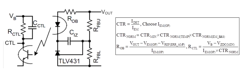

My customer is confirming TPS23750EVM-108.
When an Optocoupler was only changed, the board wasn't work well.
The Optocoupler is from TCMT1107(original) to PS2801C-1.
I couldn't find any differences but CTR.
If CTR has changed, do another pars need to change?
Could you please advise.
