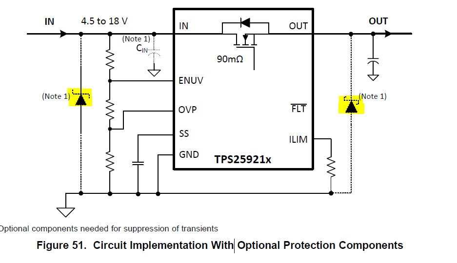

 Hello guys,
 Our customer is considering to use TPS25921 with high volume unit.
 The customer wants to reduce the number of external parts for TPS25921 as less as possible.
 They don't need over voltage protection and under voltage protection.
 Could you please tell me which parts can be removed in Figure 30 in the device datasheet?
 Also could you tell me how to terminate each non connect pin?
 Your reply would be appreciated.

  • Hi Nakai-san,
    1. Remove R1, R2, R3
    2. Connect ENUV pin directly to VIN pin
    3. Connect OVP pin to GND
    4. If fault indication is not required, connect FLT pin to GND. And R4 can be removed.
    Please you provide additional details about the application.
    1. Vin min, Vinmax
    2. Type of load
    3. Minimum and maximum load current
    3. Is short circuit protection required?
    Venkat

  • Hi Nakai-san,
    No issue in floating the FLT pin. Since eFuse is driving solenoid value, I would recommend additional protections:
    1. Output schottky diode: Part number B130-13-F
    2. Input TVS diode: Part number SMAJ16A-13-F
    Venkat

  • Hi Nakai-san,
    For output schottky diode you can consider RSX205L-30TE25 from Rohm Semiconductor.
    For TVS: I didn't find suitable part from ROHM or SHINDENGEN.
    Please give attention to the following parameters while selecting input TVS diode
    1. Minimum Breakdown Voltage >17V
    2. Maximum Breakdown Voltage <20V
    3. Max. Peak Pulse Current > 10A
    4. Peak Pulse Power Dissipation >200W

  • Hi Nakai-san,
    For output schottky diode, the following are selection points
    Voltage - DC Reverse (Vr) (Max) >20V but 30V device is chosen as it is available in bulk production and hence relatively lower in cost
    Fast Recovery type
    Current - Average Rectified (Io) > 1A
    Peak pulse power (Ppp) rating for TVS diode: In "board level" designs, it is recommended to have Ppp rating in the range 200W to 600W to protect the device from shorter-pulse width transients, ESD threats and low-level induced lightning.
    Rakesh
