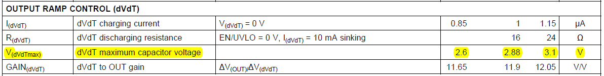

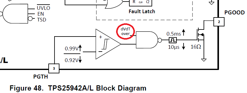

We would like to know about “dvdt over value” of PGOOD function.
We understand that “dvdt over” is “V(dVdTmax)”.
If yes, I understand as follows.
-PGOOD is High if PGTH pin voltage is higher than internal reference V(PGTHR) and “dvdt over” is “V(dVdTmax)”.
-PGOOD is Low if PGTH pin voltage is lower than internal reference V(PGTHR) and “dvdt over” is “V(dVdTmax)”.
-PGOOD is Low if PGTH pin voltage is higher than internal reference V(PGTHR) and “dvdt over” is lower than “V(dVdTmax)”.
-PGOOD is Low if PGTH pin voltage is lower than internal reference V(PGTHR) and “dvdt over” is lower than “V(dVdTmax)”.
Is my understanding correct?
Kanemaru
  • Hi Kanemaru-san,
    "dVdT over" signal is derived from dVdT pin voltage.
    “dVdT over” means the voltage at dVdT pin has crossed (Vin+3)/12, where Vin is the input voltage, 12 is the gain of dVdT and 3 is the minimum over drive voltage required to keep FET in ON state.
    In your description, “dVdT over” has to be replaced by (Vin+3)/12.
