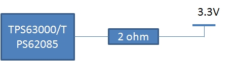

In my application, our DC/DC may be has sink current in output. So could I know the max sink current of TPS63000 and tps62085. Great thx.

    Thx for your reply, pls check below answer
    input voltage range:3.3V
    output voltage: Adjustable like 1.8V
    maximum output current/ load profile:Maxim Current 800mA
    type of the load: Resistance,about 2 Ω, The resistance one side is DC/DC output and another side is 3.3V DC.

  • Hi Lubomir
    Sorry for late reply.
    question1, No, we just need 800mA maximum load(steady-state).
    question2, please refer to the picture as below:
    TPS62085 is not able to sink current because it is working in PFM and PWM mode. The mode of operation depends on the load.
    TPS63000 has negative current limit but there is no specification for negative current limit.
