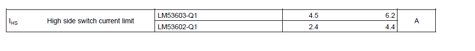

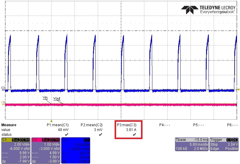

may i have your help to check the peak current of LM53603-Q1, as D/S described, the min is 4.5A, but as our measurement on EVM, the peak current is 3.8A only, which number is correct?

Is the current measured through the inductor or at the output of the converter?

The test condition is VIN = +12V & VOUT = +5V / 3A. The load is using an electronic load under CC mode.
The EVM entered OCP mode when start-up with +5V/3A load. Could you please verify your load under CC mode instead of CR mode.
