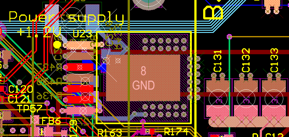

    I will forward this info to our webench and product engineer. In the meantime, do you have the schematic/layout of your design?
    Just to clarify, the PCB is changed from the previous version to the newer one?

    As for the failure, i think the Schematic/BOM and the layout would be helpful to debug the issue

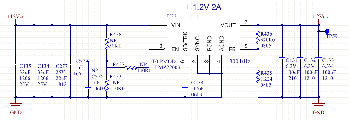

    On the new project/PCB, we had to replace 4 / 20 switcher. The PCB layout of the new project is the same as the old product.
    All capacitors are ceramic. The pin EN is unconnected.

    I look at the datasheet and it seems that there is a 2Mohm pull up to VIN on EN pin, but normally i would connect EN to some input (resistor divider or VIN) just to make sure noise does not couple in to this input.

    Cin: 300mOhms, 100uF
    Cout: 14mOhms, 330uF
