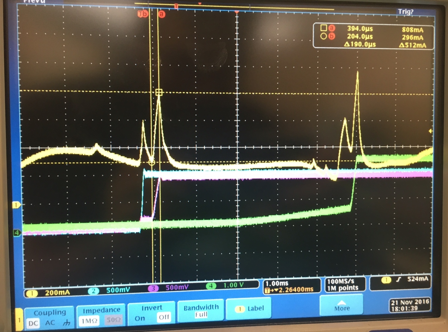

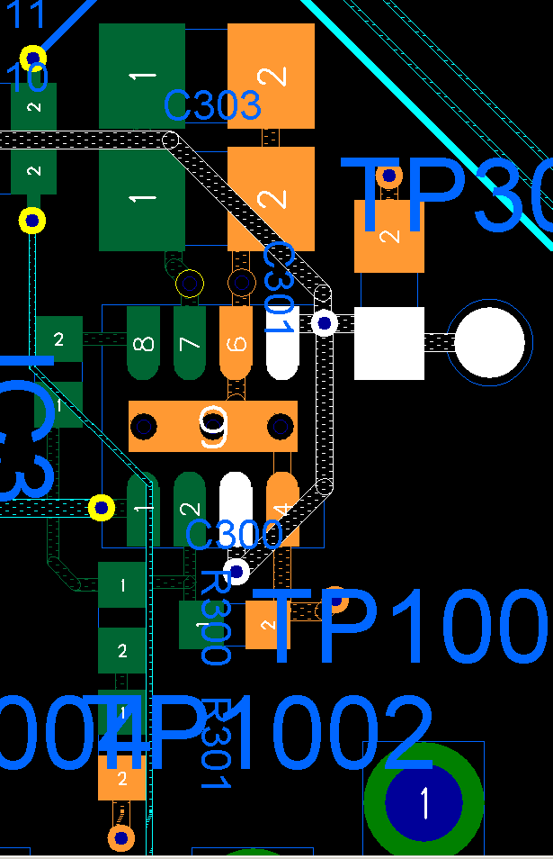

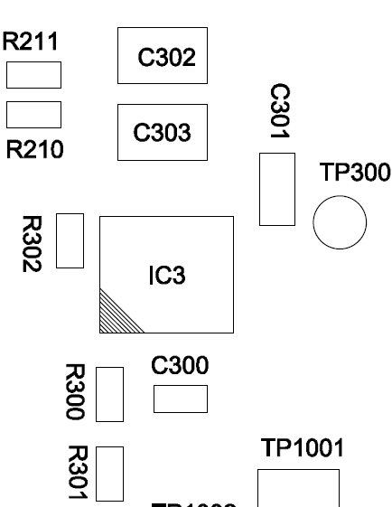

Have you experienced the LMZ10501 output collapsing? Under what conditions would the output collapse other than thermal shutdown? We are suspecting the in rush currents due to sudden increase in the load. Has anyone experienced such phenomenon with this device? Would increasing the cap at the Vcon pin help?
Below are some waveforms for 0.95V output.
