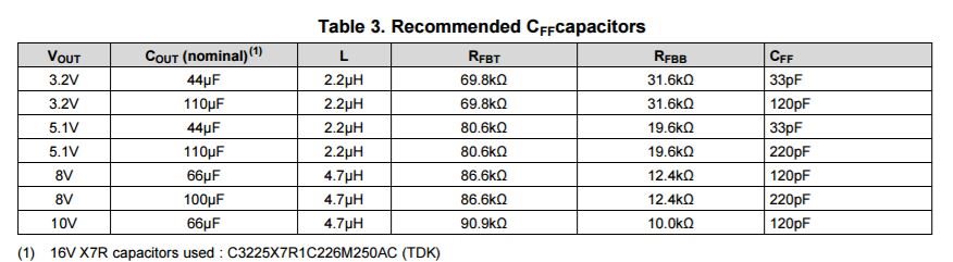

The datasheet has following comment;
The maximum recommended output voltage is 6 V. An extended output voltage range to 10 V is possible with changes to the typical
application schematic. Also, some system specifications will not be achieved for output voltages greater than 6 V. Consult the factory for
further information.
How do specifications change when output voltage is above?
My customer is considering to set output voltage into 7.2V.
