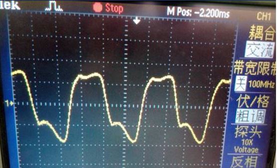

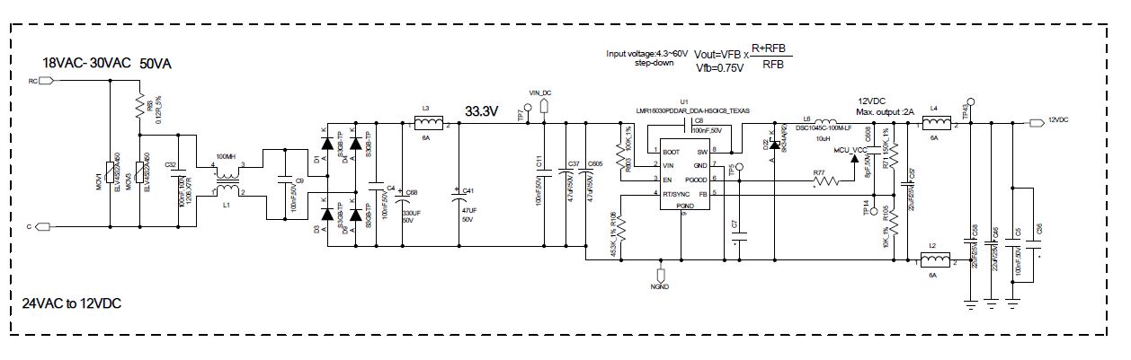

Hi TI experts,
We leveraged LMR16030 to step down a 24VAC input to 12VDC@2A output in a thermostat project (see schematic diagram below), where the AC source input is full bridge rectified to DC before feeding to LM16030. We noticed that when LMR16030 is connected to a load and source 1.6A current, it somehow affects AC source input waveform(original Sine wave),and we observed corrupted Sine wave signal. This is not what we want, as we expected that the AC waveform remains Sine Wave while LMR16030 is functioning. Is there any way to fix this issue, please kindly help? Thanks.Peter
