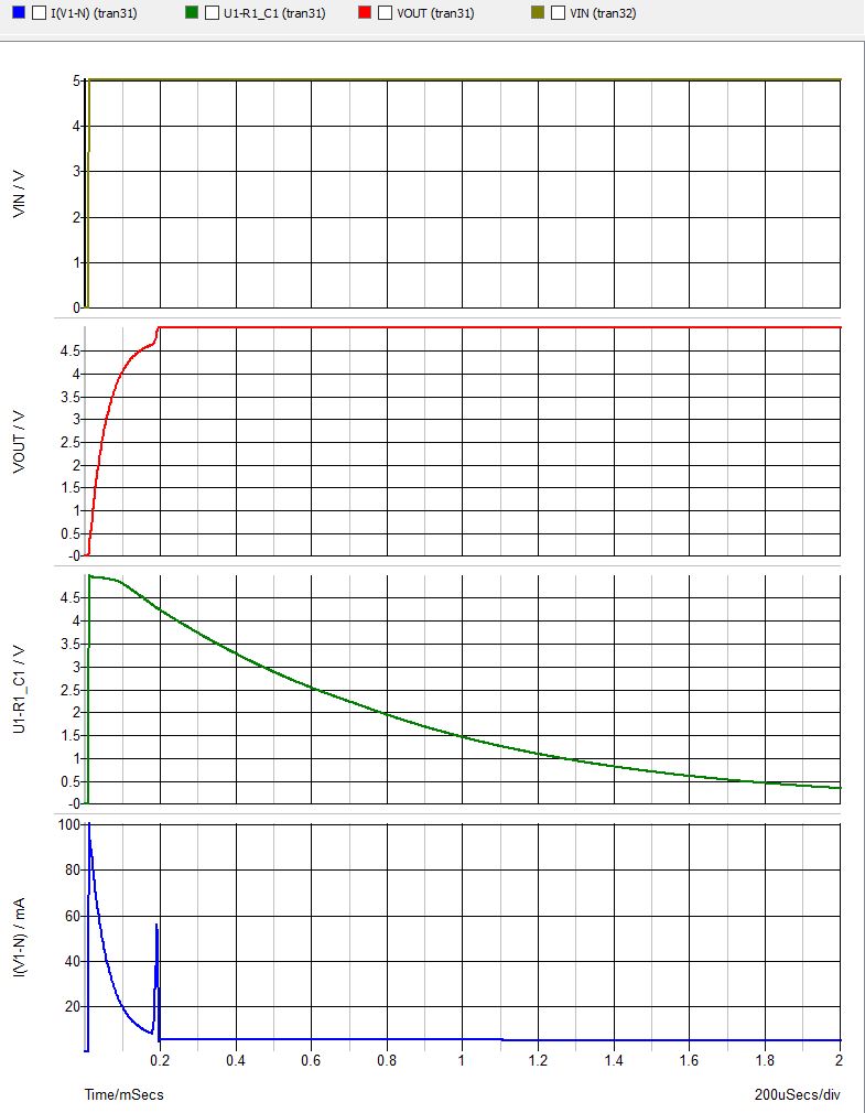

Here's a circuit based on the TPS27082L that I came up with as a low cost/simple in-rush limiter for use on a USB dongle application.
The current is limited to a maximum of 100 mA, but of course this could be designed for higher or lower levels:
The transient results are:
