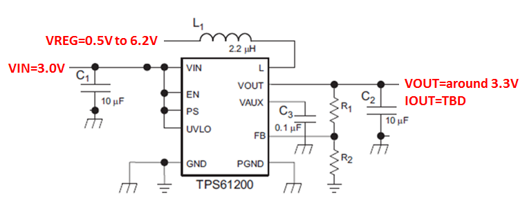

Hi Team,
Our customer would like to use the following conditions(separate “VIN” and " regulation voltage(VREG)").
Because, Maximum VREG is 6.2V so this voltage is higher than the recommended operating conditions of VIN.
Could you please let us know if you have any concern?
[Conditions]
-VIN=3.0V
-VREG=0.5V to 6.2V
-IOUT= TBD
-VOUT=around 3.3V
