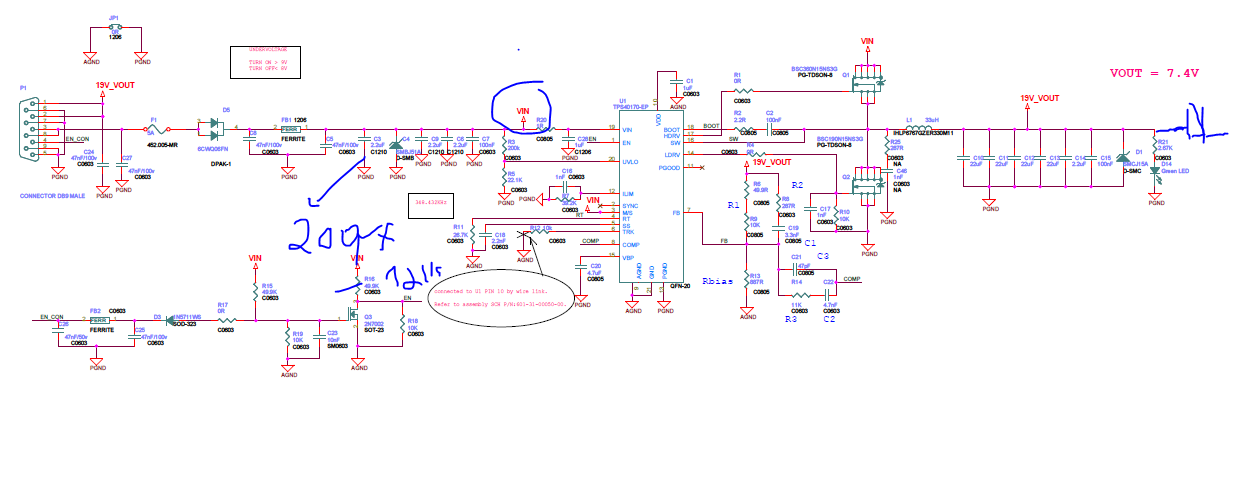

I have a problem that the ENABLE PIN demage when i power up the DC2DC ,what can cause to this?
BR,
Ilan Mazuz
  • Over voltage is the most likely cause.  Can you post your schematic?

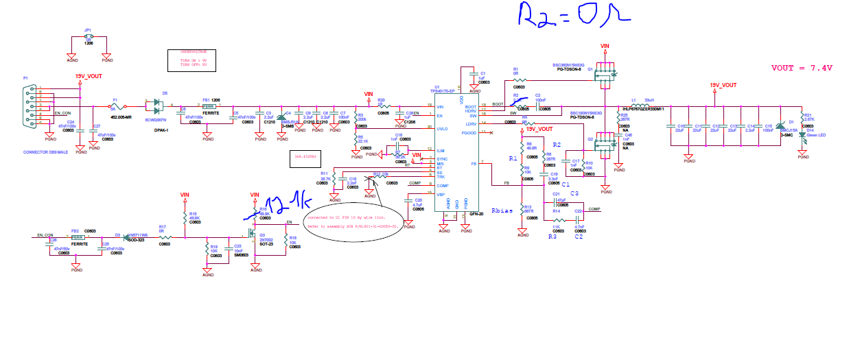

  • PLS pay attention:
    R2 change from 2.2ohm to 0 ohm.
    R12 change from 49.9kohm to 121k ohm.
    thank you

  • Hi John,
    here i add more details.
    The picture is 3 dc2dc input connected to 50v power supply LAB and their output connected to servos , 2 servo to 1 output.
    The LAB power supply is on always.When we turn on and off and on ,often the enable pin demage of tps40170.
    There is addition 2 dc2dc connected to iput voltage 50v (the same vin) ,but their outputs connected to computer and other loads that are not servo.
    the enable signals are all connected toghther.
    4 dc2dc base on tps40170 the last base on tps54560.
    BR,
    Ilan

  • The board dc2dc with 40170 is connected to 2 servo.
    1. first apply 50v to his input ,when the tps40170 is disable by enable=0v,no 7.4v at output.
    2. we enable the tps40170 by put the 2n7002 at cutoff ,as result enable= 4v.
    3. apply PWM to move the servos.
    5.stop to apply PWM to servos.
    6.disable tps40170 (enable pin is grounded).
    7.then turn on the tps40170 by put the 2n7002 at cutoff ,as result enable= 4v(divider voltage).
    doing 1-7 during 10 hours ,as a result the tps40170 demage.
    The current one servo take from dc2dc is about 6A for short time msec.

    I finally see the issue that damages the enable input. The enable divider is R15 and R18. 49.9k and 10k respectively. These divide Vin by 10/(49.9+10) = 1/6.
    In the case where your servo winds down and pushes Vout (and hence Vin) up to 62V will result in 62/6 = 10.33V on Enable. This exceeds the 8.8V rating of Enable Input (and is also the ABS max rating of the TPS40170!). If you can't change the UVLO points of 8V and 9V then place a small 5.6, 6.2, or 7.5V zener across R18.
    Since this supply is set for 19V output you should really have a UVLO level that is notably higher than 19V such as 25 or 30V considering this is a 50V input power bus. The 8V and 9V UVLO thresholds as drawn would be appropriate for a 5V or 3.3V output regulator and not for a 19V output application.
    It the servo is truly reflecting energy back into the 19V output to the degree that it is pumped up to 62V I expect additional problems will occur in this system. You might consider a voltage mode controller that will allow reverse inductor current, that will operate backwards as a synchronous boost. This will tame the voltage excursions on the 19V output rail and take the reflected power out of the servo and return it to the source. You will need Schottky diodes across both top and bottom MOSFETS in that approach.
