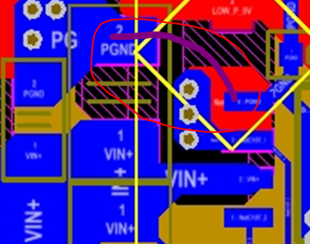

Dears,
I tested the TPS54229, the circuit is work stable, but the chip continues some minutes will be burned  when I short the output. I found the chip is strict requirement the PCB layout, is it related with the chip destroyed? Thanks very much.
Best regards!

  • Hi Jacking,
    Thanks for reaching out to us. Before we know what is happening to IC, I would like to know more info here:
    1) For the short test, is it directly short on output cap? Did you capture any waveform during the short?
    2) Could you show me the specs of the inductor you use? Inductor could be saturated during short when wrong selected.
    3) I found a big 220UF electrolytic cap used at output, could you remove that cap and test short to see whether the IC will damage?
    4) For the layout, could you show the trace or polygon connecting from input cap to GND pin( as shown below)? The trace should be on the top layer and directly connected as short and wide as possible.
    5) Did you check whether the IC is soldered well when you test short output? We found failure before when not soldering well on PGD pad.
    Let's have a further discuss when I got these info.
    Anthony

  • Hi Jacking,
    For DCAP2 devices, big output cap could worsen the loop response and lead to poor transient performance. So I would like you to remove it and try whether there will be improvement.
    For the layout, I got only one concern on the input cap to GND trace. Found no more at present.
    Anthony
