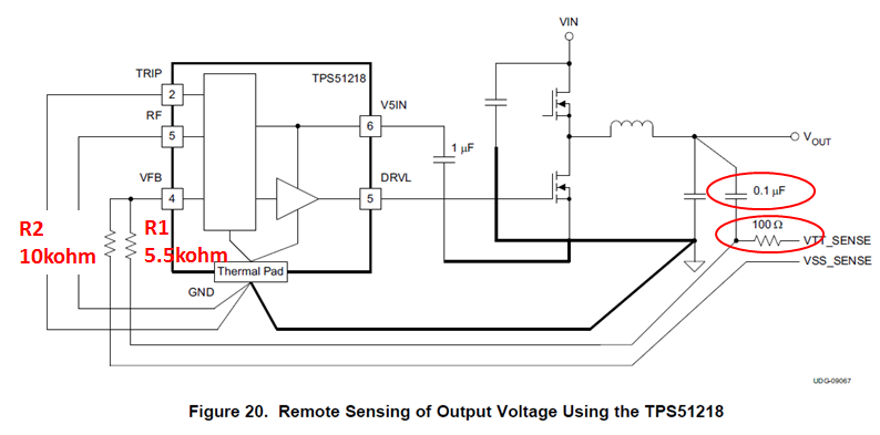

Hi Team,
Our customer would like to know 0.1uF Capacitor and 100ohm resistor of function in Figure20.
(So, why is 0.1uF and 100ohm necessary?)
Could you please let us know if you have any information?
And, I have one more question.
We understand that we should be "R1=5.5kohm (5.6k – 0.1k), R2=10kohm" if Target VOUT is 1.1V(R1=5.6kohm, R2=10kohm).
Because, there is 100ohm(0.1kohm) between VTT_SENSE and R1.
Is my understanding incorrect?
