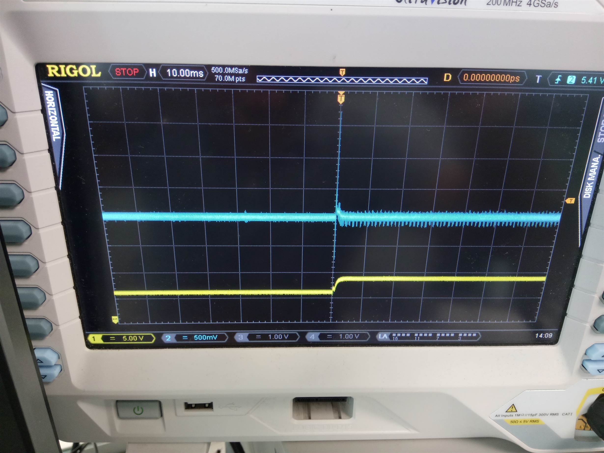

In my board we use BQ24703 (charger) and TPS54339 (DC2DC, Vout=5v, Vin = 12-19.5v).
Vac_adapter = 19.5v
Vbat = 12-16.8v
Vcharge = 16.8v
In the steady state we see clean 5v from TPS54339 Vout, but when we plug in Vac_adapter (to charge the battery) we find a huge spike (>5.5v) in TPS54339 Vout.
We measure also with TI EVM boards (BQ24703, TPS54339), measure scope images attached (5v spike, Vin vs 5v).
Just to be clear, we use short wired for measure the 5V vout.
Maybe you have any suggestion to clean TPS54339 Vout?

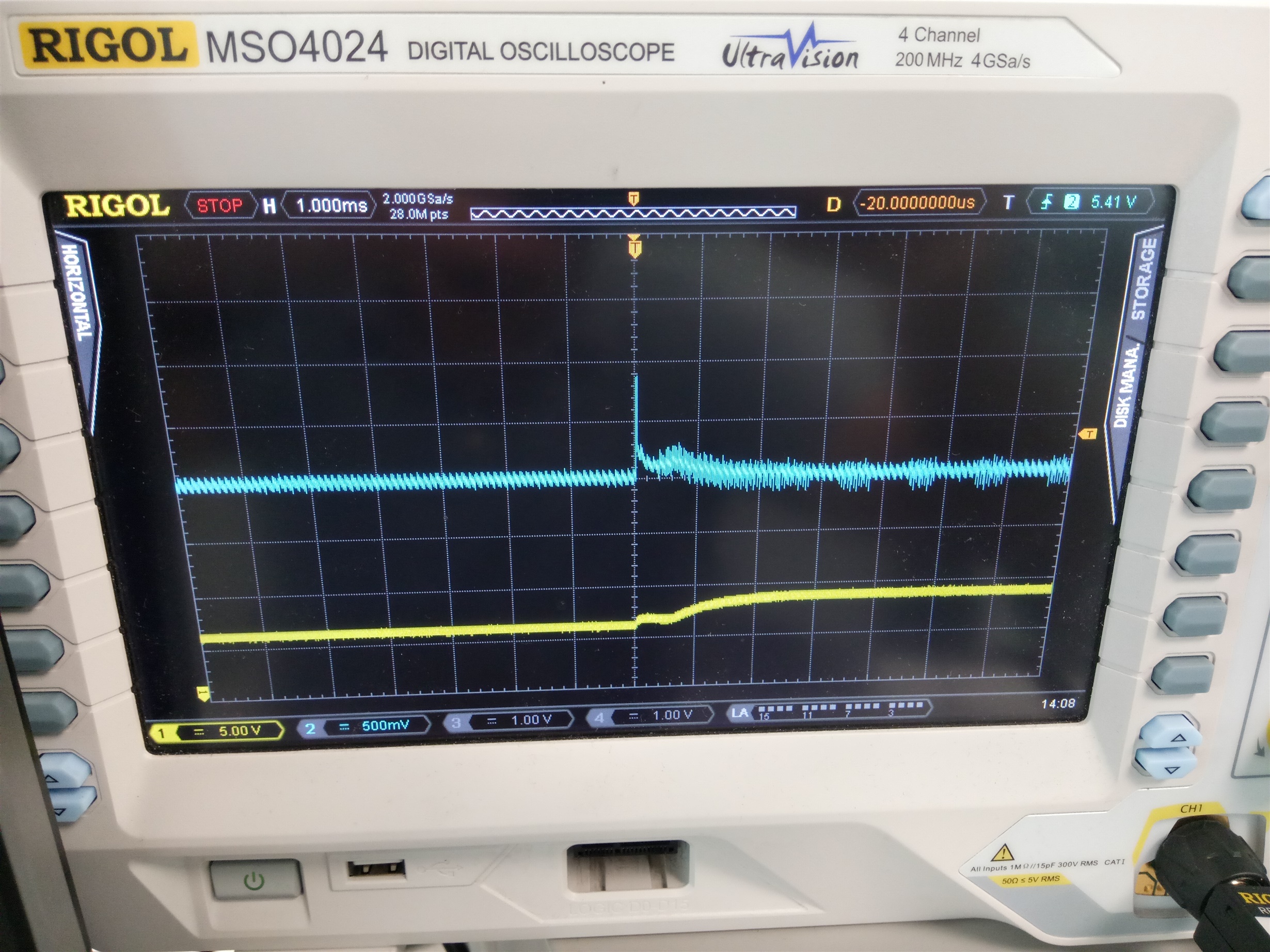

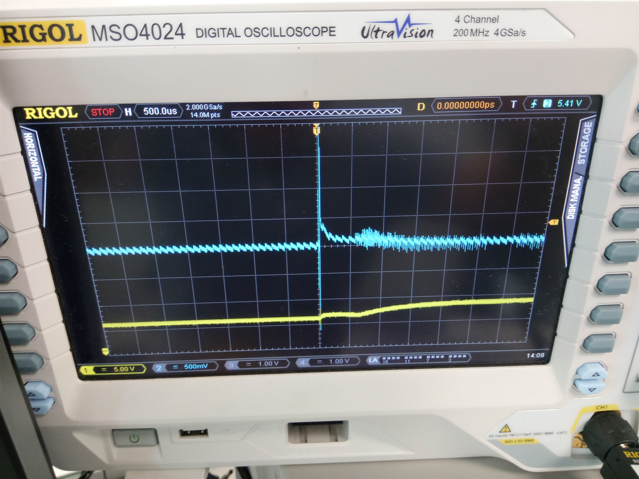

  • "Do you mean you see 600mV TPS54339 output spike when you add input source to bq24773 input or bq24703 input? What is the bq24773 or bq24703output voltage change, when you add input source?"
    Yes, we see 600mV output spike when add input source to bq24703(19.5v). the output voltage change to 19.5v, from battery voltage to 19.5v, battery voltage change between 12v (empty) 16.8v (full charge).
    "What is the bq24773 or bq24703 output voltage change, when you add input source?"
    bq24703 output voltage change to 19.5v (voltage input source).
    "Do you take any waveform to show your test result?"
    Sure, you can see here 3 pictures,  TPS54339 voltage output (blue) Vs bq24703 output (yellow).
