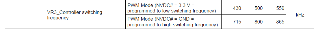

On page 30 of the TPS650830 datasheet there are to separate boxes labelled VR3_Controller switching frequency. What is the difference between the two? There are also 2 boxes labelled VR5_Controller switching frequency on page 40. Again what is the difference between the two?
