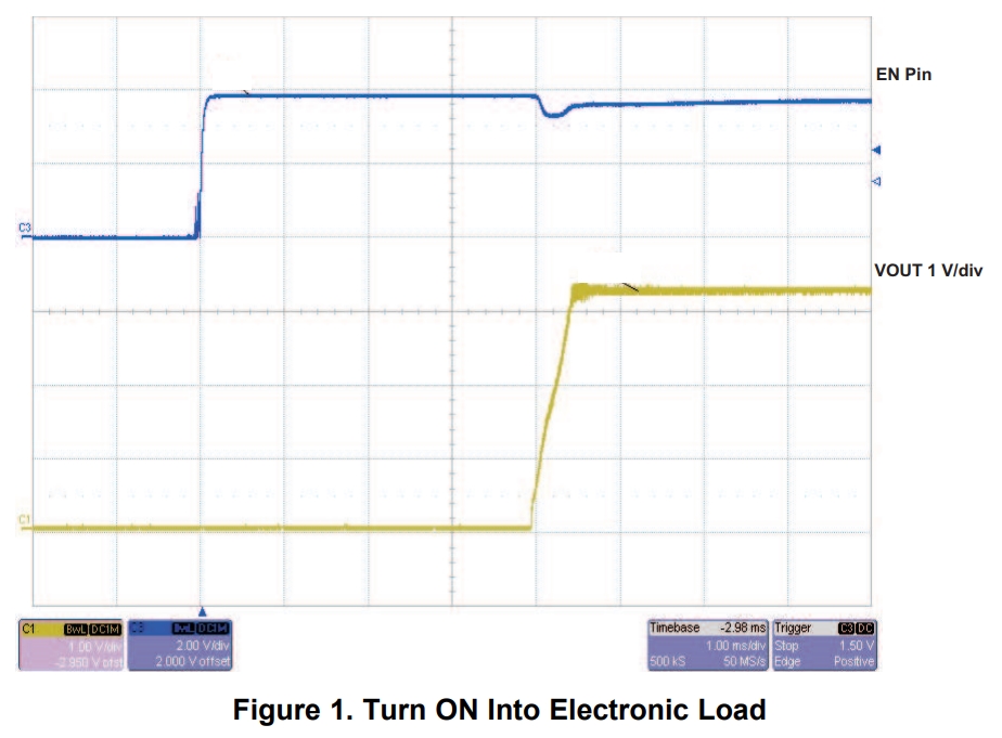

    I found the waveform on the application note of TPS63020EVM-487.
    At figure 1 shows that the delay time is about 4ms between EN and start point of Vout.
    ( It is different very much from datasheet(=50us).)
    http://www.tij.co.jp/jp/lit/ug/slvu365/slvu365.pdf
    I understand that the ramp up time of Vout depends on many parameter (as you mentioned). However I do not know how can we estimate the internal delay time which is between EN(or VIN UVLO) and the start point of Vout (=start to switching).
    Koji Hamamoto
  • I think this is just a nice example for the dependency of the startup time on many parameters. The picture shows a startup into an electronic load. I guess that the control circuit of the electronic load defines the curves and the timing.
    The built in startup sequence in the device causes a delay of about 50us from EN going high to starting switching. As soon as the device starts switching all control features for protecting the device are active and can define the behavior of the device (section 9.3.2 and 9.4.1 in the datasheet) depending on what is connected at the input and at the output of the device.

  • The picture above only shows VIN (or EN) and VOUT. You cannot see the device starting switching.
    I would expect no difference between starting the device by increasing the input voltage above UVLO threshold or by switching EN high. Switching EN high is just easier to predict and for that reason it is more suitable for an accurate measurement.
