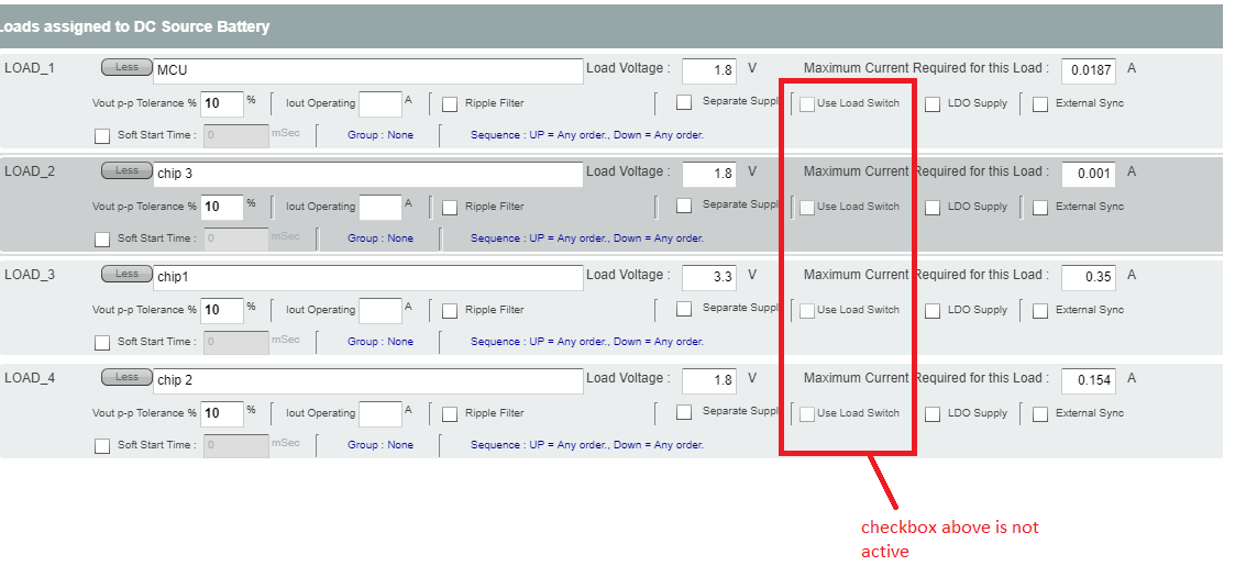

I'm trying to design power management for my embedded system. There are two supply voltages in my design which is 3.3V and 1.8V. 3.3V is used by one peripheral whereas 1.8V is shared by 3 peripherals. To lower the design cost, i want to be able to use one regulator (for 1.8V) and switch the other unused peripherals off to save power. Meaning, im trying to supply three 1.8V peripherals using one voltage regulator so i want to be able to switch off and on different peripheral voltages independent of each other.
i think "use load switch" option in the TI power Architect designer helps us to do that. However, when I entered my source and load voltages and currents in TI power Architect designer, "use load switch" option is not available to select! Please refer to the attachment.
Please help!

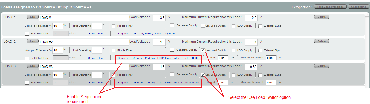

  • Hi Pragash
    To enable the "Use load switch" option, you can click on the sequencing requirement buttom on the top right. Just put a dummy sequencing requirement. This will cause the "Use Load switch" to be enabled. In the future, we will enable this for all conditions. But for now, you can use this.
    Gerold
  • Dear Pragash,
    "Use Load Switch" option is only enabled when we have sequencing requirement for the loads in Power Architect.
    Please enable sequencing option (Click on sequencing button at the top right of the loads list and select "Up Sequence" check box. You may also clock on "Sequence : UP = Any order, Down = Any order" to get to the same view). Once you enable sequencing you will be able to select "Use Load Switch" check box. This option will add load switch to your required rails. If sequencing is not important for your design - you may chose to ignore the LDO and Sequencer IC in the power tree.

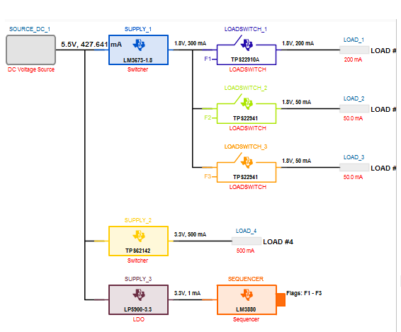

    If I understand your question right - you would like to use a PMIC (one input and 2 output DC-DC) to supply three 1.8V loads and each of the 1.8V rail should have a separate load-switch. We do not have the feature in Power architect - where you can specify the list of loads to be supplied from a single PMIC. You may see PMIC solutions by clicking on "Get PMIC/PMU Solutions" in the tree solutions listing page - this provides you with options of power trees with PMICs for some rails - but does not guarantee that specific loads are all supplied by single PMIC.
    You can force a load to be a separate supply, by clicking "Separate supply" check-box in the load list. You may also consider using single output regulator for the three 1.8V loads (If this meets your requirement) using three load-switches as below.
    Tree with single supply for 1.8V loads:
    If using a single output DC-DC  does not meet the requirements - you may search for the right PMIC IC on ti.com and use evaluation board and spice model as your starting point for your design.
