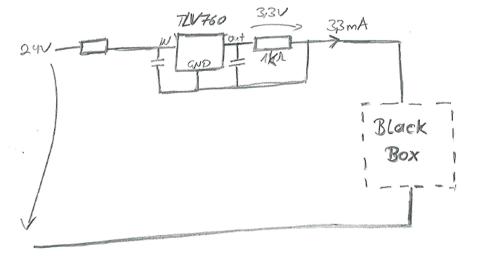

Can we use TLV760 as a current source?
Also, Is there a replacement to LM317L to use as a current source?
Thank you very much.

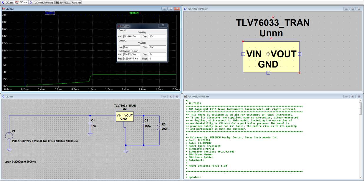

I have another question also, Please see below the question from the customer.
I looked at the Spice model of the TLV760 today. It is noticeable to me, that after the input voltage at the TLV760 is applied this 800μs needed until the output voltage is regulated. This behavior is not described in the data sheet.
Is this behavior only to be found in the model or does this behavior also belong to the properties of the component?

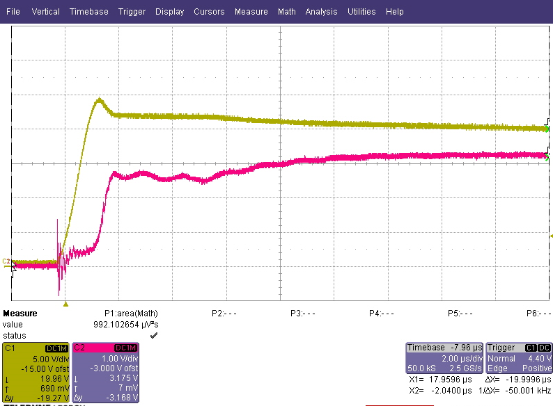

The measurement was a much shorter time between voltage application and voltage output LDO.
