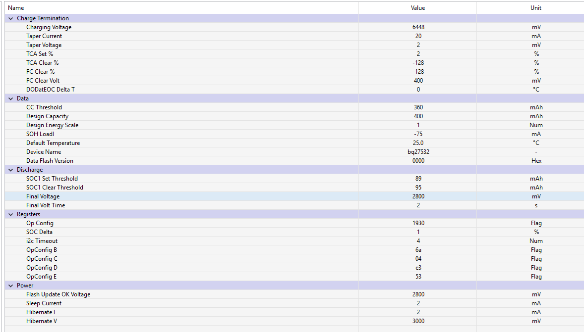

  • Hi Onyx,
    Thanks for your reply, the picture below is my newest setting for gauge module, and my device usually work at 33uA ~ 120 uA. As you said, i wait until the gauge goes to "sleep mode" and send "set hibernate" command, then removing EV2300 to ensure no communication, but after waiting for quite a while i still didn't see any power consumption change for entering hibernate mode.
    Is there anything you think i could check to help finding the reason?

  • Shiping,
    i suggest keeping the defaults for sleep current and hibernate current as the default valies and follow the instructions for getting into hibernate as seen below.. You need to send the hibernate command, when you don't have any current going into or out of the battery, and then disconnect the ev2300. The OCV measurement could take up to 30 mins.

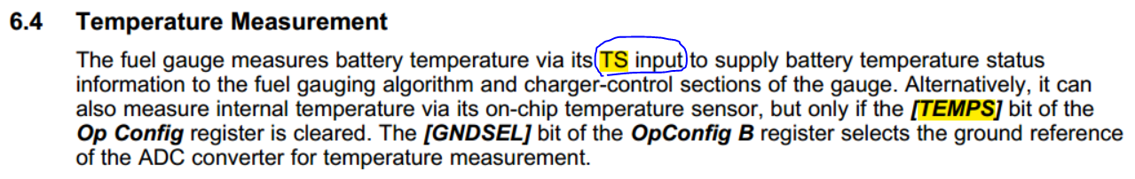

  • Hi Onyx,
    I checked the document about TS pin and from the document "screenshot 1" below it looks like TS is a input pin, how did it actually pulse that pin every 20 secs if it's a input pin?
    Also, in our design, our battery didn't have 3 pin but only 2 pins, so here is how we design it in our application at "screenshot 2". And we set [TEMPS] bit to be 0 to only measure the internal temperature. I have a concern that will this affect the observation of pulse at TS pin? Or is there any other pin i could check to observe the "wait hibernate" state?

  • Hi Shipping
    So are you saying you aren't using the external thermistor for temperature measurement? If that is the case, then i am not sure if the pin would pulse, every 20 s. It is something worth checking otherwise simply use the current measurement drawn by the gauge to determine hibernate mode.

  • Hi Shiping,
    In hibernate almost all the internal circuity is turn off. The ts pin is will not pulse in hibernate mode. It only pulses in sleep.

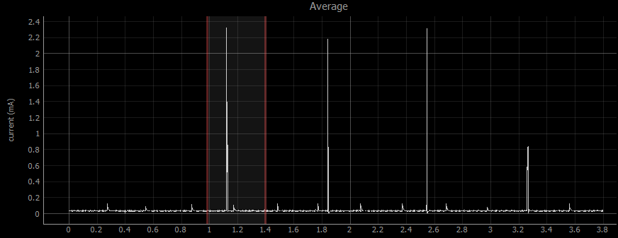

  • Hi Onyx,
    Appreciate your help with the testing.
    I followed the steps and have a question about instruction "-Make sure you do not have any load on the system that draws any current. Make sure IT is enabled", why do i need to make sure "no load on system that draws any power"? To make sure the current is below the threshold?
    The reason i ask is as shown below, there is pulse in current consumption on our device. Is this still fine to let gauge go to hibernate mode?
    I am also trying to build a clean environment to test the gauge going into hibernate mode, any idea about that?
    Shiping
  • Hi Shiping,
    If this current spikes are above your hibernate current value in the data flash, the gauge will not enter hibernate mode. You need to adjust your hibernate and sleep currents to be higher than these current spikes.
