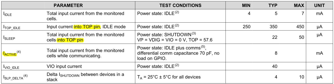

BQ76PL455A-Q1: BQ76PL455A-Q1 / TOP pin current at ACTIVE mode
Part Number: BQ76PL455A-Q1
I know that the TOP pin current is specified at IDLE mode as ISLEEP in EC. Then do you have also TOP pin current at ACTIVE mode? I'm not sure that IACTIVE means it because there is no comment of "into TOP pin" in description of IACTIVE.
