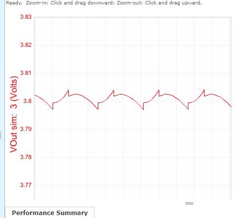

    2. Vout of our design is 3.8V, vin should typically be between 9 to 16V. A TVS diode with a reverse working voltage of 24V and a shottky diode will be added before Vin to protect against the test impulses in ISO 7637-2.
    Please find below the link to our WeBENCH design
    https://webench.ti.com/appinfo/webench/scripts/SDP.cgi?ID=12A3D1341BD602C4
    3. Yes, thank you for the LM43603 suggestion. That is another suitable device, However, this device also has a long lead time. The LM73605 and LM76003 are also devices I did not choose because of the lead time and availability since they seem to be really new devices.
    4. Is any reason you would suggest us not to go with the LM23630? I think this might be the device we will finally select as it meets most of our criteria. There is one thing that worries me though. The steady state simulation shows a curve I'm not familiar with. The ripple is of course completely acceptable, but this pattern with the peaks on the waveform is something I've never seen all the other devices we have worked with.

  • I think the LMR23630 is a good choice for your application. The waveform shown indicates that the output capacitor has rather large ESR. I cannot open the design you've shared. Please check the type of the capacitor used at the output. If ceramic capacitors are used, the waveform shouldn't look at this.
    The step change on the Vout waveform is due to the current going to the capacitor * ESR.
