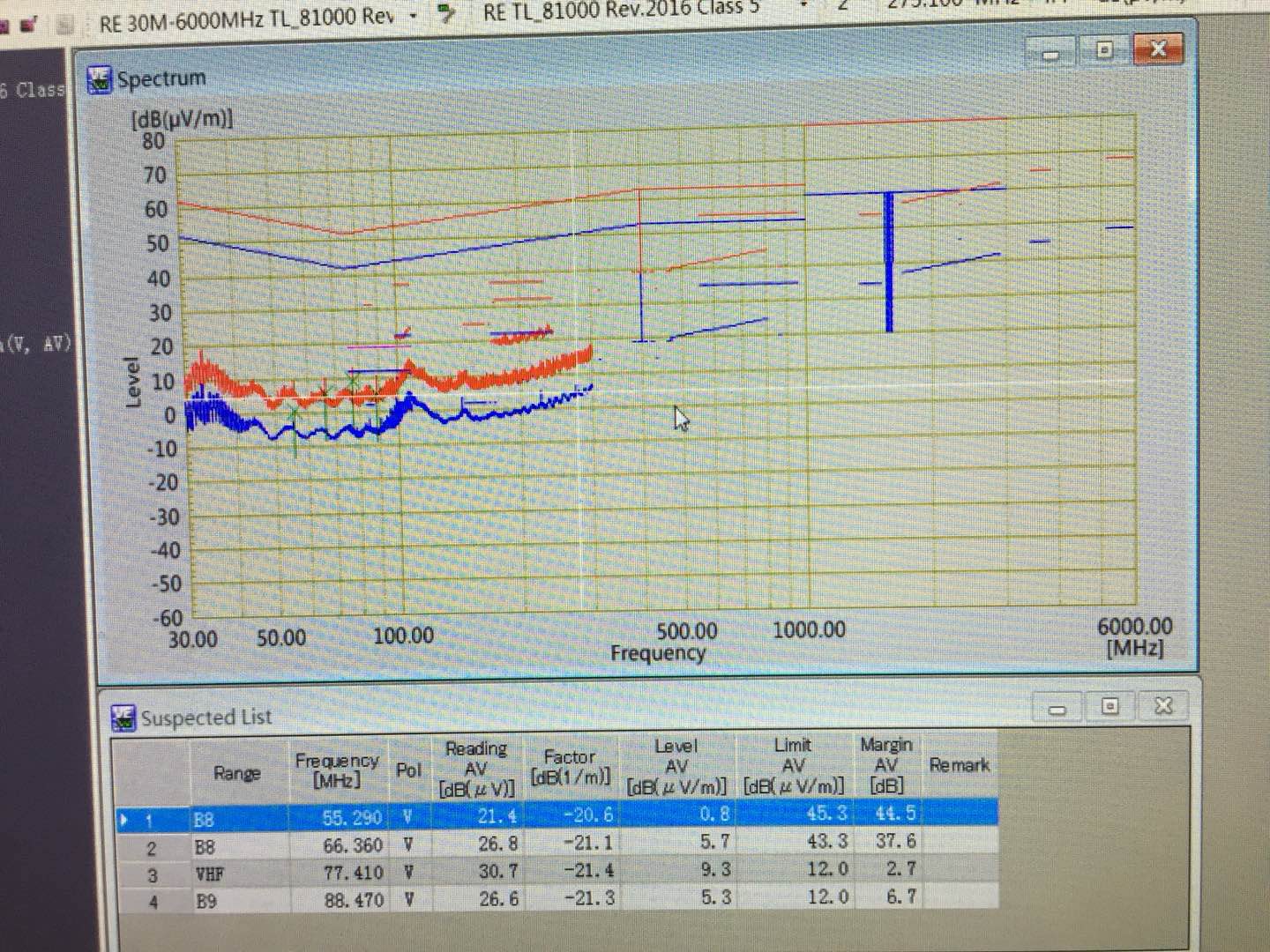

Hi  Experts:
            My customer is testing their board with the EMI specification , in the RE test, they found the harmonic frequency 55Mhz, 66Mhz, 77Mhz,88Mhz, which is derived from the 11Mhz fundamental wave. Please see the result below:
            i just want to make sure whether there is 11Mhz clock inside of the LM5161 ?
