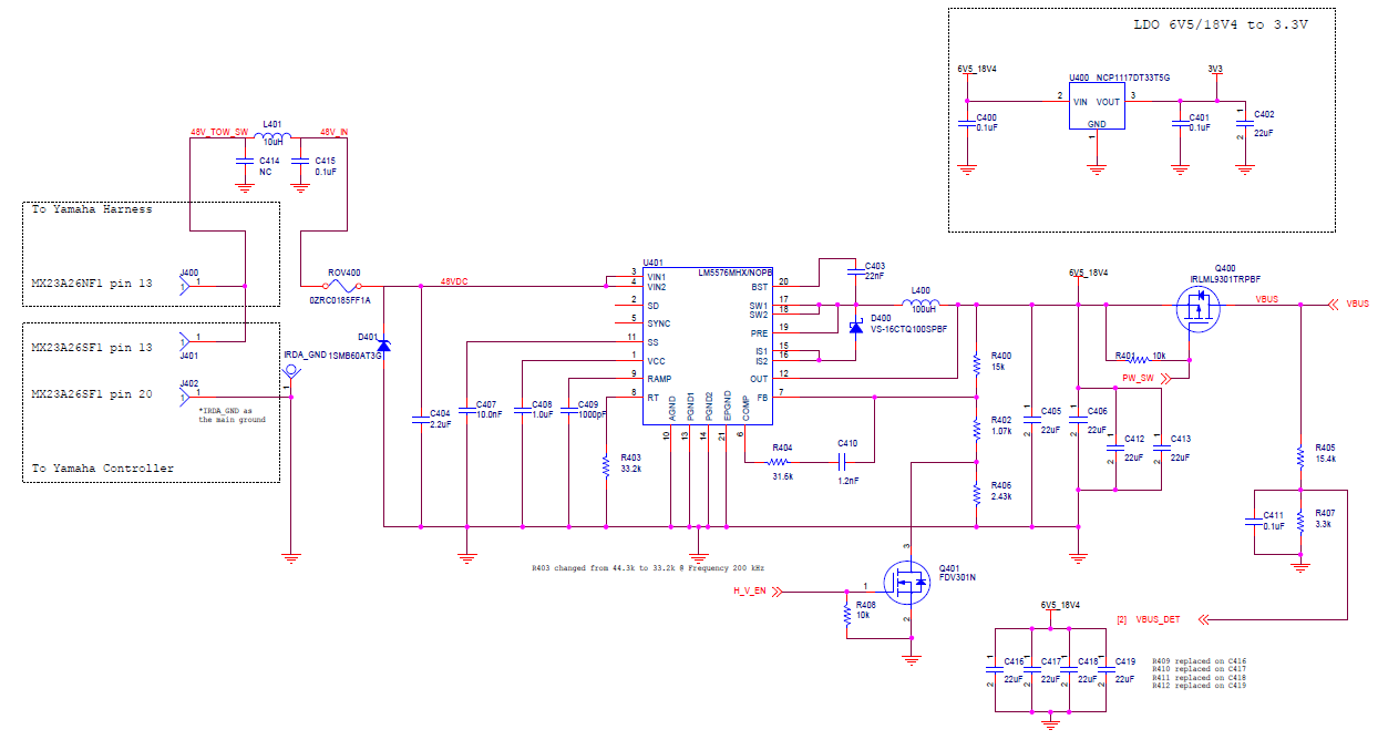

My company has a production PCB which uses the LM5576 to step down power from 48V car battery to 6.5V/18V (option controlled by an on-board MCU using FET Q401). The IC works fine when there is no load connected. However when there is a 4Ω load  (we use this simulate the current draw of our touch-screen tablet) connected at 6.5V output, the IC will fail to provide output voltage or instead give some bad intermediate voltage. Furthermore, the 6.5V also powers a 3V3 LDO which gives power to the on-board MCU, and sometimes this will be reset by our reset monitor, because the voltage dips too much.
Some anomalies to complicate the situation:
1. Our previous board version and current board version only have two changes (ADC accuracy change on the on-board MCU, and higher rating fuse ROV400). We have confirmed neither of these affect converter operation -- however our previous board version works PERFECTLY fine, and always provides output voltage at 6.5V even with 4Ω or ~1.6A current draw; but our current board version is the one that does not output well.
2. The converter works fine when the recirculating diode D400 is heated to 115F, but at room temperature it cannot bring up the voltage.
I am attaching a schematic of the power management section of our design. If anyone has seen this before, or something similar any help would be appreciated in debugging this hardware issue. We are completely baffled over here and at the factory, because there is no sensible reason why this design worked before and not now. If you need any additional details or scope captures, etc., please let me know.
Thanks in advance,
Steven

  • Hi Katelyn,
    Sorry let me clarify, the ADC is on a completely separate block of the board. It in no way interacts with the design here or measures anything on this circuit. The change is simply a resistor and capacitor value change.
    There were no layout changes whatsoever, same copper traces, same board laminate
    •ROV400 went from .85A trip current to 1.85A
    •With second board, ROV400 was removed and jumped, still has bad output
    •The issue persists even if the load is connected without the switch Q400
    While in retrospect I do question the layout myself, I do not think it is the main issue since we have a working previous version with identical layout. Also, I do not believe wrong components are installed as we have manufactured thousands of these boards, and this latest batch of 50 PCBs I have verified components on some myself.
    I am interested in what you mean by stability. Could you elaborate? Often you will hear a high-pitch audible noise (possibly coming from the inductor L400) at each output voltage step (say 0V -> 2V -> 3V -> 4V -> 5V -> 6.5V). Obviously this behavior is non-ideal and the voltage should immediately go from 0 -> 6.5V, as it did with our previous board.
    Also what do you think about the thermal characteristics of the problem? Why might it not work when cold, but then work if heated enough?

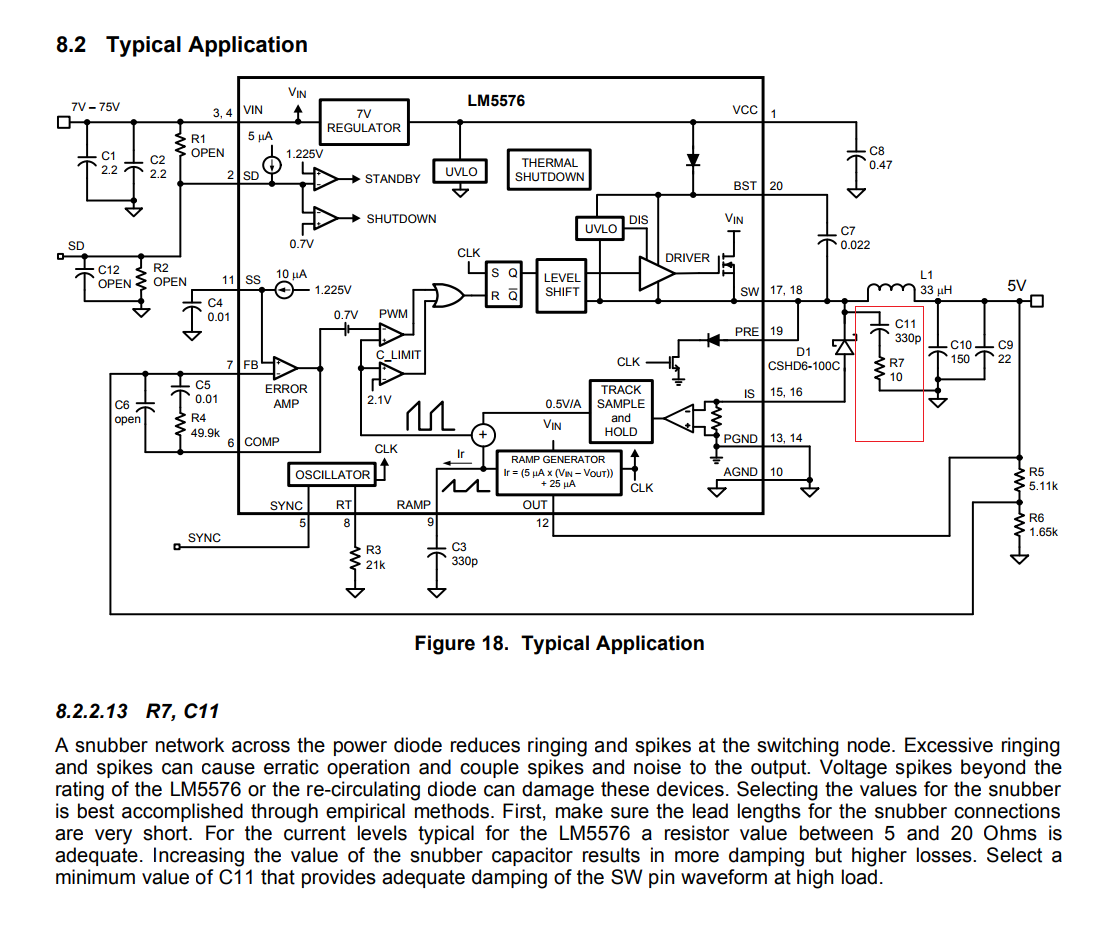

    By reading over the datasheet of the IC again, I realized our design left out the optional RC snubber network connected from SW to GND. Looking at the scope images, the inputs/outputs are very noisy when coupled to a high load. By adding the network (180pF cap in series with 10Ω resistor), the board works perfectly fine now!
    Please let me know if you can help confirm this design change to push it forward to my team.

    As you pointed out, the snubber will slow down the switch node and effectively minimize the switch node ringing and noise. Since the snubber fixes your issue, this points to the root cause being high frequency ringing coupling into the control loop from the switch node. To verify if this is different between the two boards, I would recommend taking a waveform of the switch node on the new board and the original board in order to compare the switch node ringing. To compare the switch node ringing of the two boards, it is important to use the 'tip and barrel' method with the scope. This article describes the 'tip and barrel' method. www.eetimes.com/document.asp
    Also, when you say: "the output voltage shifted from 6.45V to 6.65..6.72V until the board heats up" are you referring to the DC value of the output voltage is shifting from 6.45 to 6.65 to 6.72 or that the output voltage is oscillating between these values?
    In order to prevent high frequency noise coupling, I would recommend adding a high frequency bypass cap (100nF) between VIN and PGND. Place this capacitor as close to the device as possible. Another method would be to add a boot resistor in series with the boot capacitor in order to slow down the switch node.

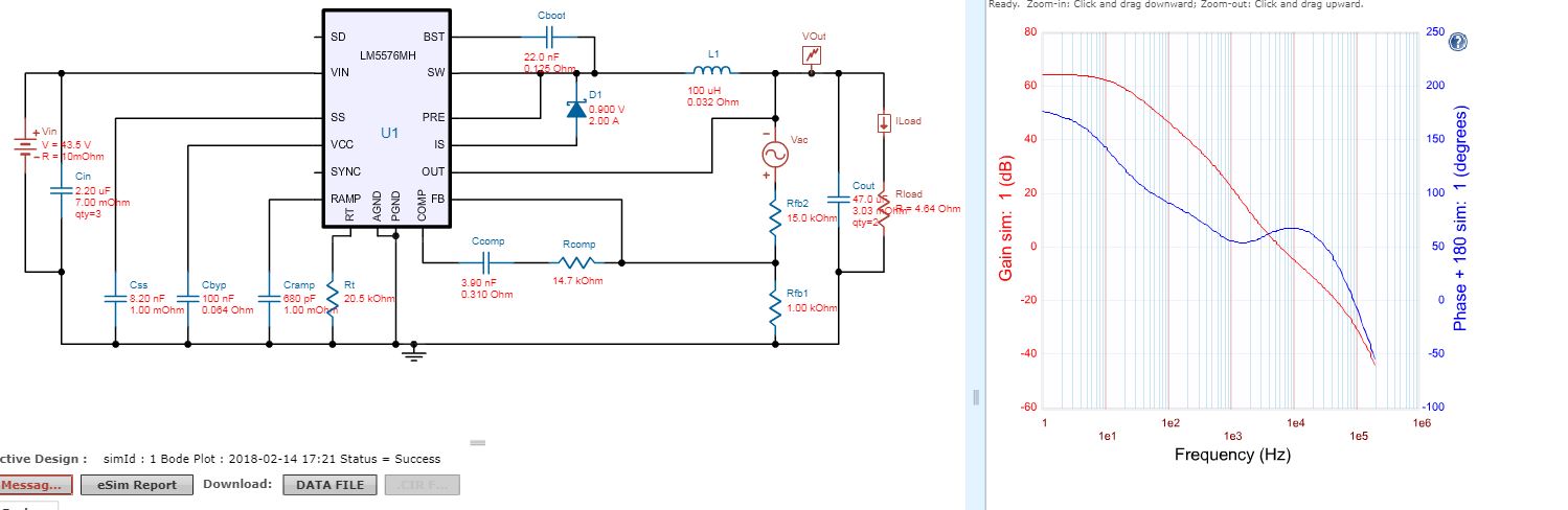

    The scope probe's high frequency capacitance is providing a path for the high frequency noise that is minimizing the effects of the switch node ringing. I believe the noise is coupling to the COMP node and creating instability. Would it be possible to add a high frequency cap (10nF-100nF) between COMP and FB?
    I also used Webench to simulate your LM5576 design. Webench recommends Rcomp=14.7kOhm and Ccomp=3.9nF. You can also try to replace these two components to see if stability is improved.
    Katelyn
  • Hi Steven,
    Attached is the Webench simulation.
    Katelyn
