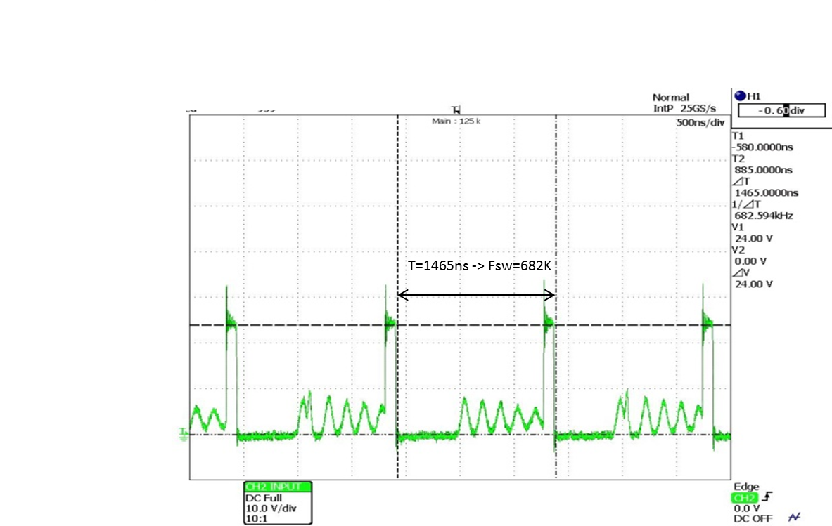

Hi
There is comparison of behavior of DCM and CCM mode on the figure 25, 26 of datasheet.
Is there any condition so that the switching frequency is same between these two mode?
Because we got the result of being decreased switching frequency in DCM with RT=11.5Kohm.
The datasheet example in figure 25 seems to have 500KHz switching freq approximately.
