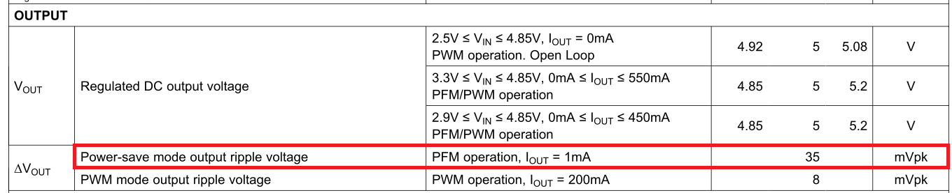

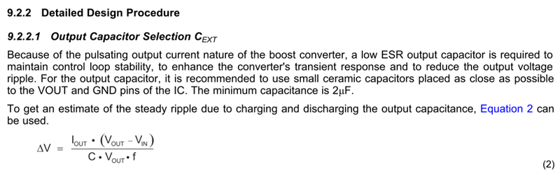

The power-save mode output ripple voltage(ΔVout) is mentioned on page 5 of TPS81256 data sheet as below.
Could you please tell me the part number or the output capacitor value(Cext) which was connected to the output node in this case ?
