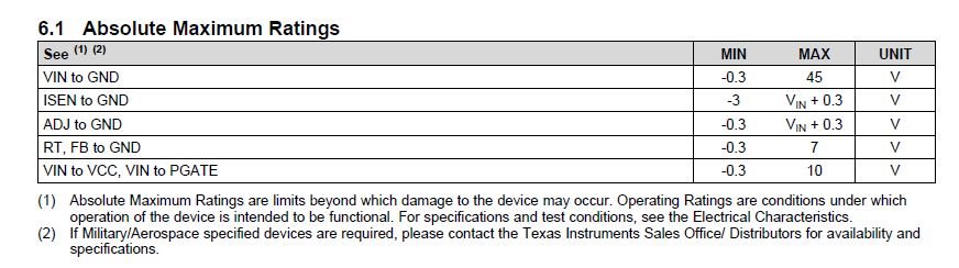

Hi everyone
We develop a board with a DC/DC converter based on LM25085
This board is powered by a 24V
Sometimes (1/100), during power on or power off operation, the LM25085 become dead. The component seems to be hot, but not burning, and the output is stucked to 0V
We investigate Vin, to determine if it go above absolute max rating, but we notice anything in this way.
Any clues ?
What could cause such a failure state ?
bests regards
  • Hi Gonzague,
    My initial thoughts are that the Absolute Maximum ratings cannot be exceeded, and the VCC voltage should not be pulled negative.
    If any pin exceeds the Abs Max ratings, this can result in damaged units:
    Also, VCC should not be allowed to go negative:
    Could you also share your schematic and layout files?  I can also review these documents for any potential causes of the damaged units.

  • I don't see anything that would cause a failure, except...I would rule out possible over voltage on the Vin to VCC pin as previously mentioned by Katelyn.
    Please can you try placing a schottky very close to Gnd and VCC (Anode to Gnd and cathode to VCC pin) of the device.
    if Vin drops quickly, the VCC cap can fly to a negative voltage. If the input recovers quickly, the voltage on the VCC cap can go out of regulation causing an over voltage on the pin (between Vin and VCC). The Schottky prevents VCC from flying to a negative voltage on a fast negative Vin transient or a fast On/turn off/Turn on cycle. From you description, I am not clear if you are turning off and then on, quickly, this could cause an issue?
    Hope this helps?
