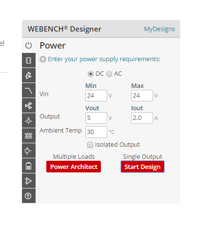

    To make your life easy, we support you with Webench, our design assistant tool. From the web page:
    You will be able to enter your power supply requirements as shown here:

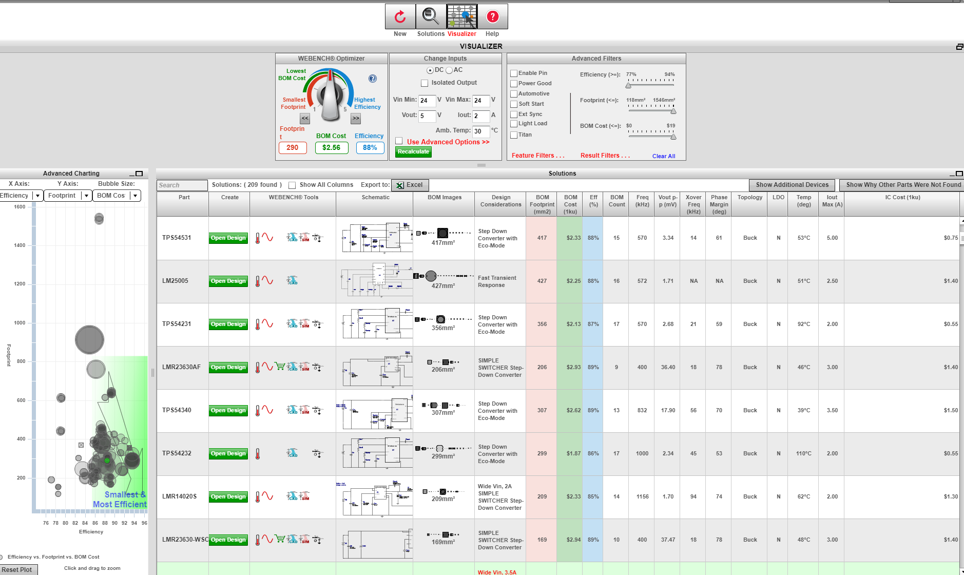

    and start your design. You will be asked to chose between 3 different power solution types:
    -Controllers
    -Integrated FETs
    -Modules
    The result I got with internal FETs and your parameter is the following:
    from this point you will be able to chose the solution that better fits your requirements also taking into account the solution size and the cost!!!
