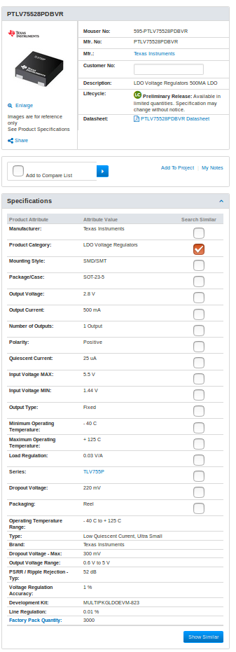

  • Hi Mark,
    As the generic data sheet TLV755P specifies that the product is available in Fixed Output Voltages range i.e 0.6 - 5 volts.
    I got samples of PTLV75528PDBVR which has fixed output of 2.8 V. Please find the image attached as reference.

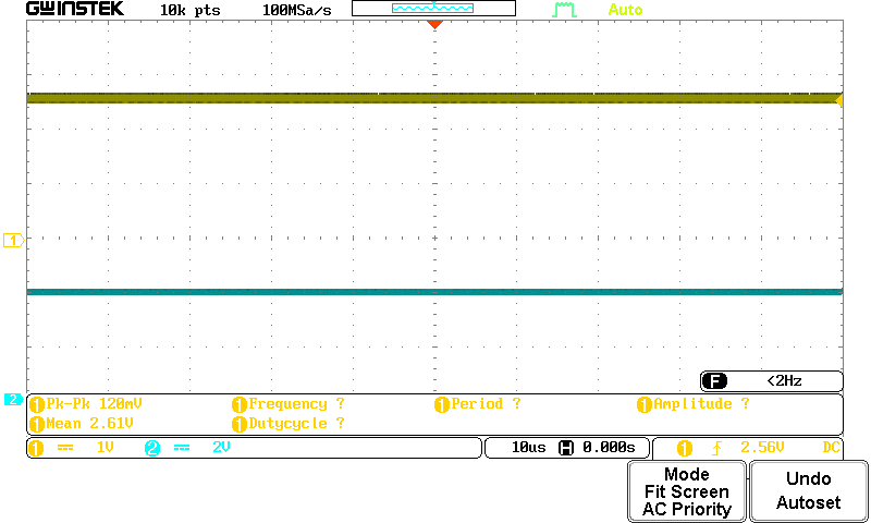

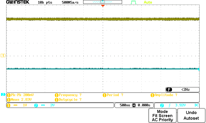

  • Hi Mark,
    I have attached the snapshot of scope with No-Load & With-Load (10ohm, 5W) current 240 mA.
    legends: 1- Outpput
    2- Input
    Image1 - No-Load
    image2- with load
    I am not getting 2.8 volts as output across the load.

  • Hello Mark,
    Thanks for looking into the issue so closely.
    No i did not connect any multimeter while taking the DSO readings.
    yes this what our concern is, I have seen LDO's to drop in order of few mV, but this one is acting weired.
