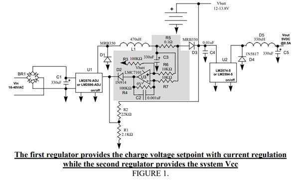

  • Hello ,
    I have refer attached document and implemented the below circuit with following changes, suitable for my application.
    As my application did not require current greater than 1Ampere, the suitable inductor value (L1) was 330uH.
    I need to limit the current below 1 Ampere. So I changed R5 to 0.47E. As per calculations, current limit should be at about 400mA.
    I have used LM324 as OpAmp IC (U3). Input voltage is 24VDC.
    When I connected the battery, the current was restricted to 400mA. But I observed that, the temperature of IC rose upto 75 degree, after which it was stable. Package of IC LM2575 is TO220, IC is used without heatsink and circuit is in open air.
    As the current is restricted at 400mA, I am unable to figure out the reason for such high temperature rise. On the field, the circuit will be enclosed in box and ambient temperature would rise to 50 Degree Celsius. In such circumstances, it wont be possible to use the IC with such high temperature rise.
    Please inform what could have gone wrong?
