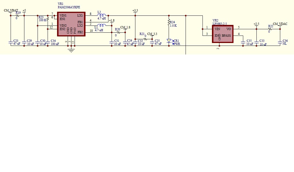

I am debugging a new design that uses the LP3985-2.5 to power a FPGA.  The same FPGA also has banks running on 3.3V.  I have a series 0 ohm resistor between the regulator and FPGA so I can disconnect the FPGA load leaving only the output capacitor.  There is 10 uF in parallel with 47 uF on the input of the LP and 10 uF on its output.  There's a 10 nF between bypass and ground.  I have two prototype boards.  Originally there appeared to be a short between 3.3V and 2.5V (under the FPGA, of course).  I removed and replaced the FPGA and the short is gone but I am using the same LP3985-2.5.  With its output now disconnected from the FPGA but still connected to its output capacitor, the LP input measures 3.359V and its output measures 3.216V.  I have a second board whose LP3985 output was originally attached to the FPGA and measured 3.3V, so i removed its zero ohm jumper.  Disconnected from its load the second board's LP3985-2.5 measures 3.24V with its input measuring 3.28.
So it is possible on the first board, the LP's output was being dragged above it's nominal 2.5V output value.  From the simplified block diagram, this wouldn't appear to damage the LP since it cannot sink current if the output is pulled above its regulation value.  On the second board, however, there is (and was never) a short, so it is difficult to explain how it is no longer regulating.  I have attached the schematic sheet.
Any thoughts are most appreciated.

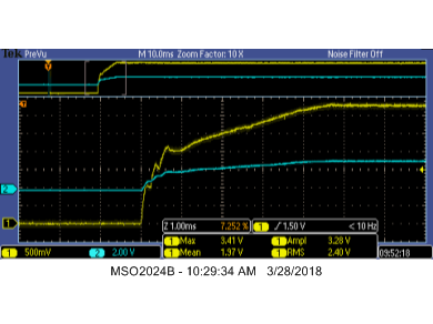

  • Hi Ryan,
    Thanks for the fast reply.
    Since Vin is driven by the same 3.3V source I suspect was shorted to the output, there can't be any time when Vo is above Vin.

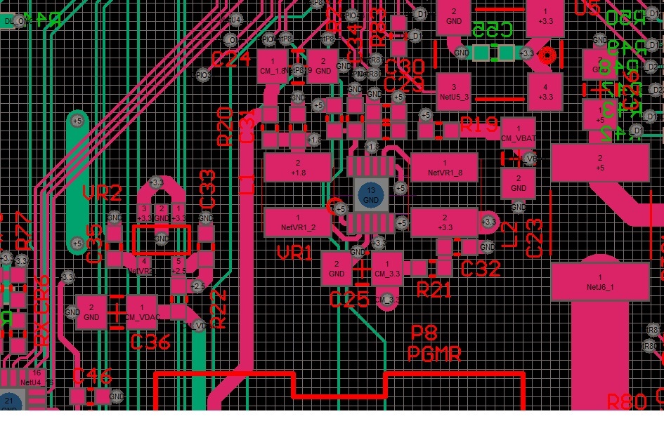

    Here's an oscilloscope capture of in and out (enable is attached to in), a schematic of the power system and the PCB layout:
    The PCB is 6-layer with dedicated layers for +3.3 and ground.
    Scott

  • Hi Scott,
    I cannot see a decoupling cap close to the input pin of LP3985-2.5. C25 and C32 are too far away.
    Kai

  • Hi Scott,
    Thanks for the details and scope shot.  As  indicated the input capacitor is a bit away from the LDO which will limit its impact.  On a similar note, it is best practice to provide a same layer GND connection for external components to the GND pin of an LDO (shown in green below).  However, I do not believe either of these is causing the issue you are experiencing currently due to your scope shot.
    Could you confirm that for your second board R22 was removed before you powered up the LDO?  This is a very useful data point as it removes any potential leakage from the load biasing the output.  If R22 was not removed isolating the LDO output, would it be possible to see Vin and Vout on the same scale in a scope shot with a fresh LDO with R22 removed?  When replacing the LDO also be sure to remove any residual flux as flux can cause unintentional leakage paths.
