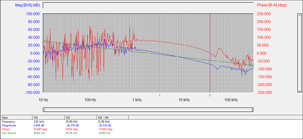

    1. The customer is injecting on TP7/TP8 on the eval board and measuring with respect to “ground”, which is now the -12V output.  What they're finding is that they get only noisy gain and phase measurements at low frequencies, with the noise level converging on a signal around 100Hz
