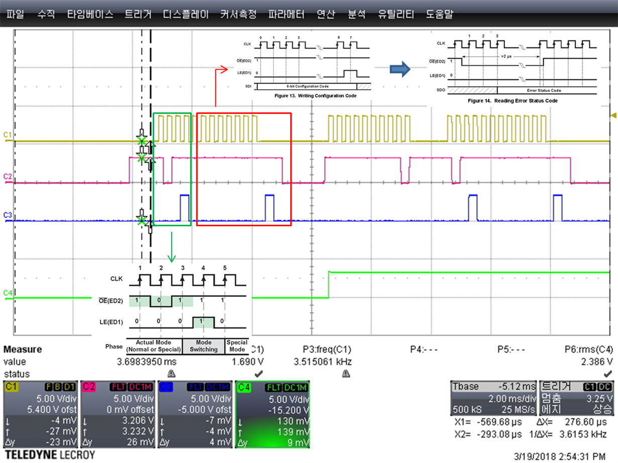

Concerning TLC5916, I have some problem.
Normal mode is good work but it is not enter to special mode.
(CLK,_OE,LE clock is same as datasheet)
* Test Condition
1. SDI, CLK is generated by MCU(I have tried to SPI and GPIO)
2. CLK Frequency : 4KHz (Tested while changing the frequency)
Refer to attahced file
Could you check to this problem, and inform to me?
Thanks and BR
PJ
  • Hi, PJ,
    TLC5916 special mode has two two functions: Error Detection and Current Gain Control.
    After checking your waveform, it seems that you're Current Gain Control function after Switching to Special Mode.
    Please change you code to Reading Error Status Code as the following figure shows:
    Please let me know if this sloves your problem.
    Thanks.
    Kenneth

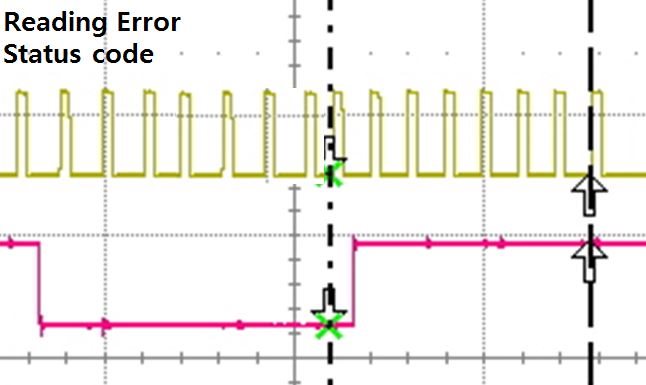

  • TLC5916_Special mode_error__20180402.pptxDear Kenneth
    Thanks for your cooperation and quickly response.
    I have tested your request, the test result is same(SDO data is wrong or not detect.)
    Please checking attached file and inform to me the improvement.
    Thanks and BR
    PJ

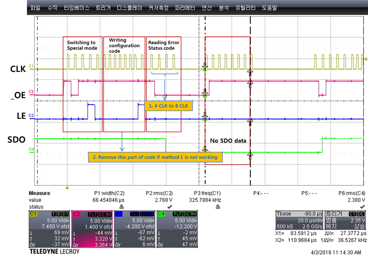

  • Hi, PJ,
    To narrow down the problem, please try the following two methods:
    1. Complete CLK number to 8 at OE=LOW and see if you can get right result.
    2. Skip writing configuration code and just send reading error status code as 1 descriped and see if you can get right result.
    Thanks.
    Kenneth

  • Hi, PJ,
    Please see detailed description in the following figure:
    Thanks.
    Kenneth

  • Hi, PJ,
    Currently your OE is low during clk 2 to 4, please keep OE low during clk 2 to 8 like following:
    Kenneth

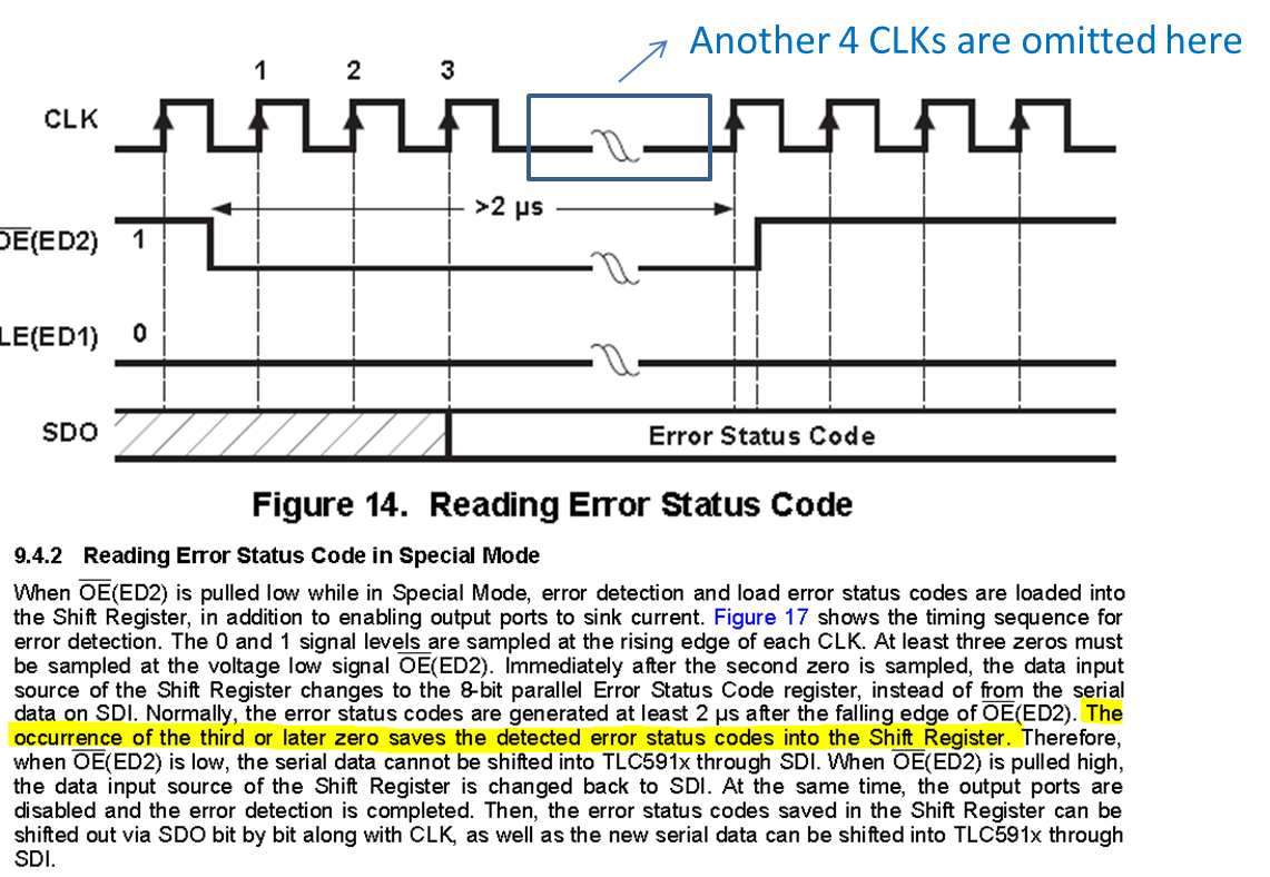

  • Dear Kenneth
    Test result is good working.
    But Could you explain that add clk(from 4 to 8) for good working?
    And Should I apply to FW in this timing?
    If I have changed from TLC5916 to TCL5954, Is this same?
    Thank and BR
    PJ
  • Hi, PJ,
    In figure 14, there're another four CLKs omitted and as you can see from 9.4.2, "The occurrence of the third or later zero saves the detected error status codes into the Shift Register."
    If you changes to TLC5954, timing diagram is not the same ,and you can refer to Status Information Data (SID) in datasheet for details.
    Since your problem is solved, I'll close this thread and please help to click Resoclved from your side.
