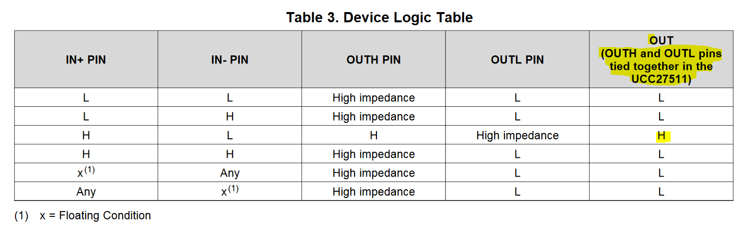

Can I tie the OUTH and OUTL output pins of the UCC27511 MOSFET driver if I do not need to use different speeds (resistors) for MOSFET turn on and trun off.
Best regards
Buddika

Hi Buddika,
Thanks for you interest in our gate drivers and Welcome to e2e. I am an applications engineer working with UCC27511 and will help you with any Qs.
UCC27511 has a split output, OUTH will only go high if IN+ is high AND IN- is low therefore the splitout can be defeated by tying OUTH and OUTL together making one OUT as described in the datasheet logic table.
