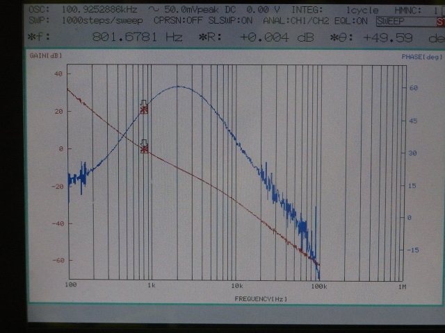

We measured the phase margin of POE+ circuit (prototype board) with TPS 23751 using Frequency Response Analyzer.
The phase margin is 45 ° or more, but the crossover frequency is about 1 kHz.
Is everything OK?
In the transient response test, the output voltage is within the acceptable range (24 V ± 5%).
【Test Conditions】
●Vin=42V
●Vo=24V
●Io=0.02A
【Result】
●Phase Margin : 49.59°
●Gain Margin : -54.5dB
●Crossover frequency : 801Hz
I have attached a screenshot.
